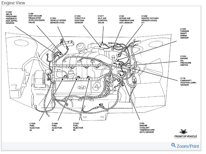

Is the camshaft position sensor hard to change and where is it located?

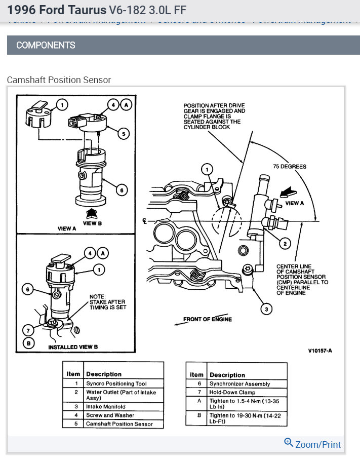

Here are instructions on how to change the camshaft angle sensor which is where the distributor used to be. (Below) This is called a synchronizer FYI.

The camshaft position (CMP) sensor is located either on left side of engine block, between cylinder heads or right top of engine cylinder head, below valve cover (depends on engine). If the eighth digit in your VIN is anything other than "S", you will have to perform a CMP sensor syncrhonizer procedure. If the eighth digit of your VIN is "S" then simply disconnect and replace the sensor. If you need the synchronizer steps let me know.

I need to know how to install this synchronizer. I cannot mark the old one because it came apart inside. It seems to me that the cam position sensor needs to be timed with number one piston at TDC. Is this correct?
I do not have the Ford tool T95T-12200-A, so I would like to learn another procedure.

Hey dbaker806! You are right, the cam sensor must be timed with number one up. You can buy the tool from a local parts store most generally, OTC, etc. However, the tools are application specific.
The problem you might incur is verifying it is lined up correctly, using a graphing meter to watch the waveform power balance test with cylinder one injector unplugged, and monitor for activity on any other cylinder. If there is activity on another cylinder while the number one injector is unplugged, than it is installed wrong.
Other than that, it is trial and error.

I am replacing a camshaft sensor housing. If my number one cylinder is TDC what position would the inner sensor flange be in? (The metal piece that passes through the sensor magnet)

If I remember correctly it should be lined up with the gap in the housing where the actual sensor goes. In other words it should be in the center of the sensor itself on number one.

Where is the cam position sensor on the car listed above 3.0 V6?
Wednesday, August 1st, 2018 AT 7:36 PM (Merged)
JUSTDON
  • 150 POSTS
While standing in front of the car, it is on the right side of the lower intake man, right on top of the block. It is where the distributor would be.

I hope you have gotten an answer by now, two months later. Anyway, my 1997 Taurus with 3.0L single cam, sheared the syncronizer pin that drives the sensor and oil pump. Replacing the sensor was part of the process.
First, locate the timing mark just behind the crank pulley. It is a pointed piece protruding from the block just car-forward of the crank sensor which sits above the crank pulley. If practical, loosen the spark plugs so the engine can be positioned easier with a socket and flex handle. You must put the TDC mark on the crank on the timing mark at the top of the compression stroke. To do this, bump the starter while holding your finger over the number one plug hole to feel compression, or insert a piece of rubber hose in the plug hole with a balloon on the other end and watch for it to inflate. This will be the beginning of the compression stroke. Stop when TDC mark is just short of timing mark.
Put a 21mm socket and flex handle on the crank nut to position TDC mark on the timing mark. Do not crank or bump starter or you start over. Disconnect the negative terminal from battery. Remove the sensor connectors on the throttle and intake tubes. Undo the air intake hose, PCV, and throttle assembly (leave throttle and cruise cables attached - it will swing out of the way nicely) Next, remove the wire protector just above the cam sensor and tie them back out of the way. Before you remove the sensor, you must have a sensor positioning tool (an over priced $50.00 plastic part available on internet or at some parts stores) which aligns the syncro and sensor to the camshaft.
Make a mark on the sensor housing and intake manifold so that you can align it after replacing the sensor. Remove the sensor connector, and the two sensor bolts with a 5.5mm socket and lift it straight up. You will probably find the small magnet that fell out of the sensor. Unless the syncro needs replacing, leave it as is. Using the alignment tool, rotate the housing and the sensor vane until the tool fits flat on top of the housing, and point the arrow toward the housing washer and clamp nut. Attach a new sensor - hopefully with one whose magnet is completely enclosed. Re-assemble in reverse order. Check timing with a timing light, referring to shop manual for correct setting.

It is in the rear of engine in between the two cylinders.
