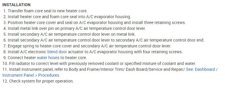

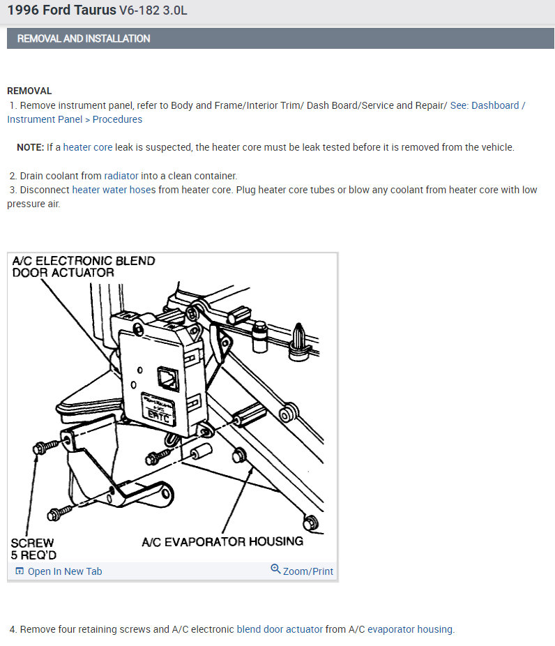

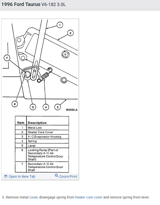

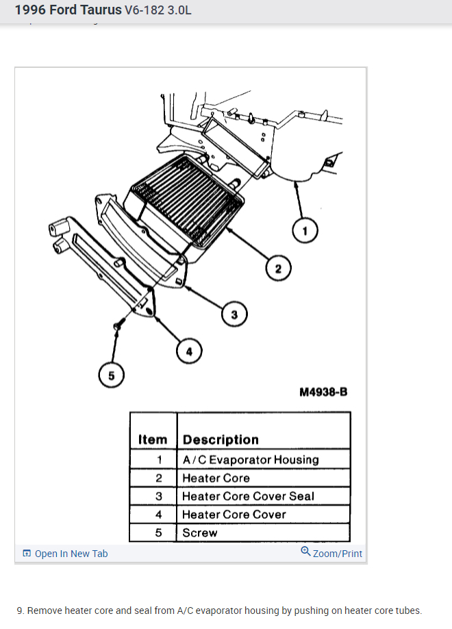

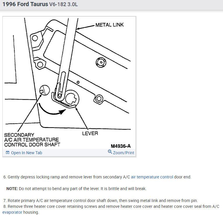

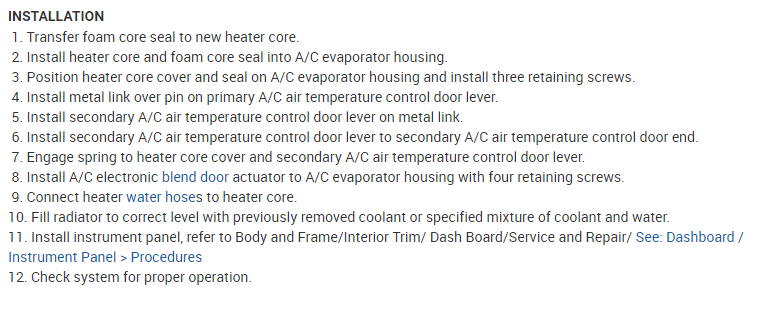

You could have an issue with coolant circulation thru the heater core.
It is possible to have clog in the heater core or the lines. Which can make it difficult for the coolant to pass through the heater core. Which will lead to poor heater performance.
First try flushing the heater core. This can be done simply by removing both of the heater hoses and running water thru the core. This can clean out any restriction or buildup that might be inside the.
https://www.2carpros.com/articles/replace-heater-hoses
