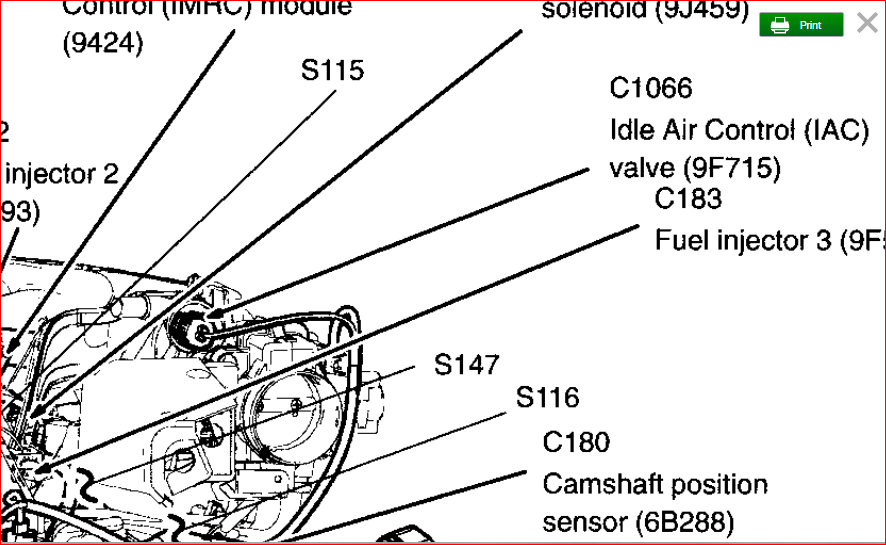

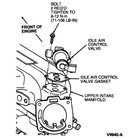

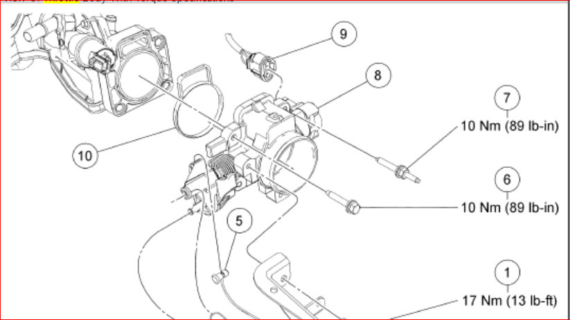

It sounds like you many be having two different problems related to the throttle body. Number #1 is a gummed up/varnished throttle body blade. I'm attaching two tutorials showing you what is involved. This first one is for your erratic idle. The second is for a throttle body cleaning.
https://www.2carpros.com/articles/how-to-replace-an-idle-speed-control-motor-iac
I'm also attaching two pictures (below) of the location of the idle air control valve and the throttle body. I hope this helps and thanks for using 2CarPros.

You may have a bad IAC ( idle air control) but try cleaning the throttle body first. Remove the intake snorkel, have someone hold the throttle wide open for you and scrub the back side of the throttle plate and surrounding bore with an old tooth brush and some carb cleaner. Be sure to spray some into the small holes next to the throttle plate. That should help stabilize the idle. If it still has a problem, replace the IAC.

The idle air control is common for this issue. It is mounted on top the engine. It has 2 bolts and an electrical connector.
Try starting the engine and then remove the connector and see if the idle drop to a low idle.
https://www.2carpros.com/articles/engine-idles-too-high
The high RPM is why it slams into gear.

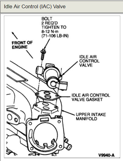

Your issue is likely the Idle Air Control Valve (IACV). It rests on top of the throttle body and is easy to replace - - just has two 8mm bolts, a gasket, and a small wire clip. If you remove the IACV, look inside... if it is black with soot, likely it needs replacement.
Since your check engine light did illuminate, it wouild be wise to get the exact codes. There may be other things hidden. Remember the car computer is not a tell-all, and just because the code says there is a fault, it doesn't mean that replacing the part which the computer says is malfunctioning is the cure.
But in most cases with the IACV, just replacing it is the cure.

The idle air control valve could be bad. You can check it by removing it and looking at the bottom. You will see 2 chambers, and a conical "plunger". Actually, it's not a valve, but a motor that screws the cone in and out to control the air flow during idle. It may be stuck, which may explain the intermittent high idle.
