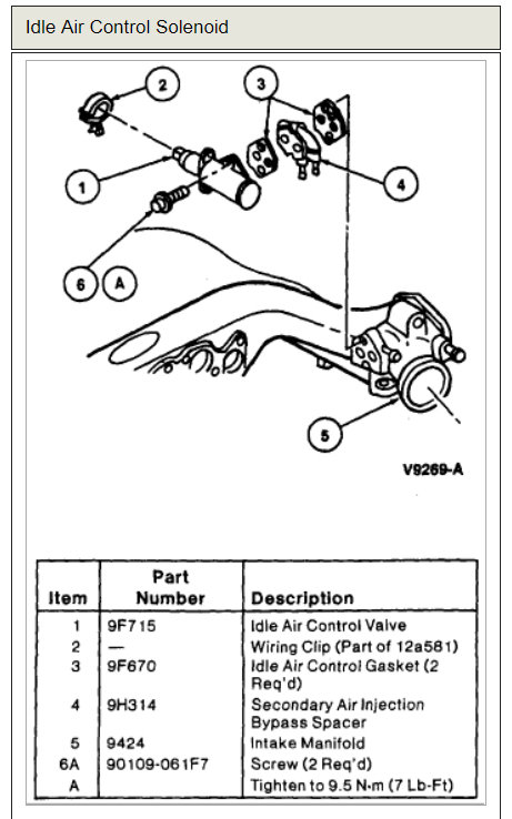

Yep you are on the money with the IAC motor which had problems in this car. Here is a guide and some diagrams (Below) on how to get the job done.
https://www.2carpros.com/articles/how-to-replace-an-idle-speed-control-motor-iac
We should check for vacuum leaks just to be safe
Here is how the job is done on your car (below)
Please run this test and get back to us.
