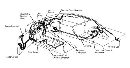

I am purchasing the vehicile that has the number pad on the driver side of the car. I need to reset it because no-one knows the combination and I almost got locked out last night. The keys wouldn't even open it. What do I do? I'm scared to lock it feeling that I'm going to be locked out.

If u do not have a remote control u can add and program one so u can use it the numbers u need is located inside the trunk on the processor
https://images.2carpros.com/forum/automotive_pictures/99387_Graphic1_175.jpg
