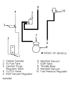

Vacuum hose became disconnected cannot find other end connection. Car runs terrible I have looked every where I need a diagram I guess one on car not good

ENGINE SIZE ???
https://www.2carpros.com/forum/automotive_pictures/99387_Graphic_44.jpg
https://www.2carpros.com/forum/automotive_pictures/99387_Graphic1_21.jpg
https://www.2carpros.com/forum/automotive_pictures/99387_Graphic2_15.jpg

Engine size 3.8 6cyl a metal hose (tube) comes from under the throttle body (i guess thats what its anyway on top in center it says 3.8 litre) and runs to fiiting on valve cover in rear. About 10 inches before this is a tip off tube pointed straight up with a rubber hose this is the hose im talking about about 18-24 inches long more toward the back than the front thx Frank cant find other end
