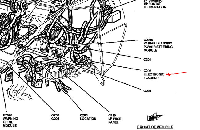

My turn signals do not work and I have replaced the turn signal, washer, and bright light assembly, but I cant find the turn signal flasher, can you help me?

The electronic flasher no. 18 below is located behind left side of dash, above fuse block.
https://images.2carpros.com/forum/automotive_pictures/12900_flasher_5.jpg
Check out the images (Below). Please let us know if you need anything else to get the problem fixed.
