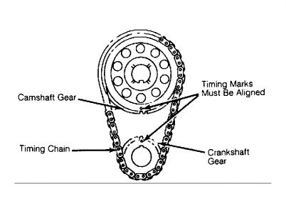

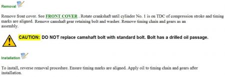

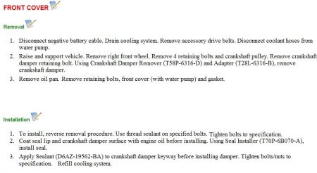

How do I replace the timing chain on a 1994 3.0liter non-SHO Taurus GL?

Sunday, August 22nd, 2010 AT 12:16 PM
