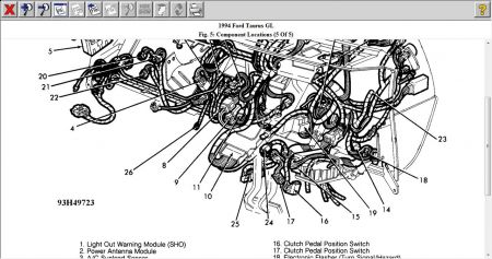

The rear turn signals and flashers don't work, although the brake lights do. I changed the bulbs and the fuses, but it didn't fix the problem. Where else should I look?

Check the electronic flasher see below item no. 19
https://images.2carpros.com/forum/automotive_pictures/12900_flasher_33.jpg
