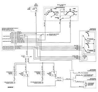

my wipers dont wsork and we tried to replace the motor, the governor inside the cab and the switch witch tells me its a wire problem. i have power in the motor area and no power from that point to the inside of the car as far as the wires go. what do i do. i have been trying to figure this out for weeks now and am lost.
Oct 28, 2008 at 9:28 PM
BMRFIXIT
  • 19,053 POSTS
start with the fuses
https://images.2carpros.com/forum/automotive_pictures/99387_Graphic_41.jpg
Oct 28, 2008 at 9:44 PM
GRUMPYNETTA
the fuses were the first thing i changed there are all new fuses in the car
Oct 28, 2008 at 9:48 PM
BMRFIXIT
  • 19,053 POSTS
What I meant is start with the fuse checking the power
do u have power at the fuse then move on to the next following the wiring diagram
need manual CHECK IT @
https://www.2carpros.com/kpages/auto_repair_manuals.htm

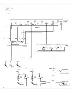

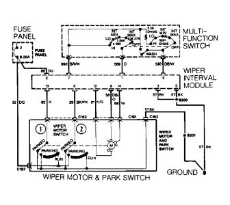

my email is jschi7@aol.com and thank you. Also how do i check my ground? i am a female trying to fix her own car and having a rough time doing so.
Oct 30, 2008 at 10:08 PM
BMRFIXIT
  • 19,053 POSTS
EMAIL WAS SENT need to use a 12 volt test light know if you are to test the ground place the clips on a power (B+) when u touch ground with the test light it should lights up if not then bad ground switch the clips to a ground (B-) check for power light should light up where you have power start with the fuses check for power
