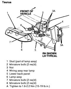

how do i replace the bulb for the tail light and turn signal on a 1993 ford taurus.

Bulbs can be serviced from the inside of the luggage compartment by removing the luggage compartment rear trim panel, if so equipped. REMOVAL: Disconnect the negative battery cable. From inside the trunk, remove the lower back panel trim cover Remove the nuts securing the rear lamp to the lower back panel, then pull the rear lamp away from the vehicle. Remove the socket(s) from the lamp body and replace the bulb(s). Brake light mounting-1995 Taurus shown
https://images.2carpros.com/forum/automotive_pictures/261618_0900c1528006395e_1.jpg
INSTALLATION: Install the bulb(s), then install the socket(s) in the lamp body. Install the lamp and use the retaining screws to secure it. Install the trim cover, then connect the negative battery cable. Please not that these instructions are for the SEDAN style taurus. If you have the STATION WAGON style Taurus, please let me know and I will post the correct instructions for that vehicle. Hope this helps.. Thanks for using 2carpros.com!
