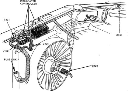

Good now what does it look like and where is it on the car??? I sure thank you and I am making another donation

Sorry for the delay-it's located @-see below: Front radiator support
https://images.2carpros.com/forum/automotive_pictures/12900_c_37.jpg
The Integrated Control Relay Module or Constant Control Relay Module (CCRM) is located at the front of the engine compartment, on the upper radiator support.
