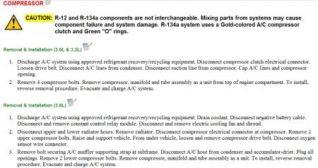

i have a 1993 ford taurus and the copressor froze up on me is there anyway to fix it for cheap or should i just buy a new one. and how do you install it step by step.
Jul 15, 2010 at 1:00 PM
BLUELIGHTNIN6
  • 16,542 POSTS
you could remove it and have it rebuilt or just buy a rebuilt one. .
https://images.2carpros.com/forum/automotive_pictures/261618_Noname_2472.jpg
