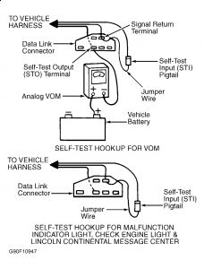

I was driving my car home and when I stopped at a stop sign my car just cut off then, I started it back up.

Clean out the idle air control valve and test the TPS and clean MAF sensor

VISUAL CHECK & EQUIPMENT HOOKUP
Complete all steps in BASIC TESTING article in this section before proceeding to self-diagnostic tests. Ensure vacuum hoses and EEC-IV wiring harnesses are properly connected.
Apply parking brake, and place shift lever in Park (A/T) or Neutral (M/T) position. Block drive wheels. Turn off all electrical accessories. Connect appropriate test equipment to vehicle as follows:
Analog Volt-Ohmmeter (VOM)
1) Turn ignition switch to OFF position. Set VOM at 0-15V DC range. Connect positive lead of VOM to positive battery terminal.
2) Connect negative VOM lead to Self-Test Output (STO) terminal of Data Link Connector (DLC). See Fig. 3 . Connect timing light, and go to KOEO SELF-TEST. Activate KOEO SELF-TEST by connecting jumper wire from Self-Test Input (STI) pigtail to signal return terminal of Data Link Connector (DLC) with ignition on.
Scan Tester
Follow manufacturer's instructions to hook up equipment and record service codes.
STAR Series Tester
Turn ignition switch to OFF position. Connect color-coded adapter cable leads to diagnostic tester. Connect 2 service connectors of adapter cable to vehicle Data Link Connector (DLC) and STI pigtail connector. Connect timing light. Go to KOEO SELF-TEST.
CHECK Malfunction Indicator Light (MIL)
Turn ignition on. Connect a jumper wire between Self-Test Input (STI) pigtail and signal return terminal of Data Link Connector (DLC). See Fig. 3 . Go to KOEO SELF-TEST.
Fig. 3: Connecting Self-Test Equipment
