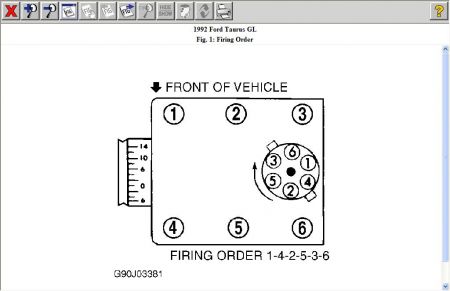

Can anyone tell me where the timing marks are for a 1992 Ford Taurus 3.6L? I also am needing to find the degree of timing as well.

Hi denial442 and welcome to 2carpros The ignition timing is 10degs BTDC at an RPM of 770-830
https://images.2carpros.com/forum/automotive_pictures/12900_timing_17.jpg
