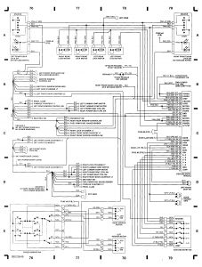

1992 Ford Taurus lpower door locks
201,000 MILES • 6 CYL • FWD • AUTOMATIC
MYBIZ6040`
location of door lock control unit to install a remote, thanks
Aug 30, 2008 at 2:20 PM
BMRFIXIT
  • 19,053 POSTS
Keyless entry module for a sedan is located in the trunk , on right side of rear seatback on station wagon located behind left rear quarter panel rear of wheelwell
https://images.2carpros.com/forum/automotive_pictures/99387_tauraus_1.jpg
