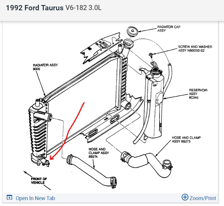

My cooling system needs to be drained and replaced and I am having a hard time locating the drain valve on the radiator, can you give me a description of where to look?

If the car has the splash shield under the engine, remove it, then you will be able to access the draincock at the bottom of your radiator....

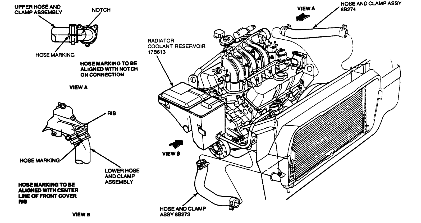

The radiator drain valve is on the left side of the radiator in the tank near the bottom. Here is the location in the images below. Check out the images (below). Let us know if you need anything else.
