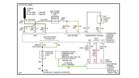

Where is the cooling fan relay located on 1991 ford taurus?

See cooling fan circuit below
