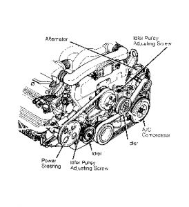

Hi, I am trying to change the belt on my 90' Taurus SHO, but I don't know how to release the tensioner on it, could you please help me out.

Loosen the nut on tensioner and back the secrew
https://images.2carpros.com/forum/automotive_pictures/99387_Graphic1_640.jpg
