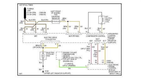

1989 Ford Taurus RADIATOR FAN
177,000 MILES • 6 CYL • FWD • AUTOMATIC
RZGALLEGOS
RADIATOR FAN NOT WORKING AND COOLANT RESERVOIR IS BOILING AFTER USE
Oct 19, 2008 at 1:11 PM
  • 75,988 POSTS
Direct battery voltage to the fan and see what happens-if it comes on-find the engine coolant temperature sensor and test it out, also see below cooling fan circuit
https://images.2carpros.com/forum/automotive_pictures/12900_cf1_9.jpg
