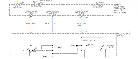

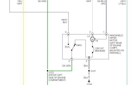

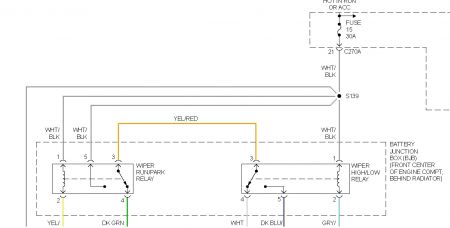

recently when I closed the back liftgate, the radio went out and the power windows and the wipers. If I click the remote lock for the doors I can get the windows to work, but no luck with the wipers or the radio.
It is in the wiring I am sure but do not know how to locate the schematic I need. any thoughts?

What model? I didn't see anything that just said ford station wagon? I can usually find a wiring diagram.
Nov 8, 2010 at 8:11 AM
HNDRSB
thanks for the quick reply, its a taurus se wagon
Nov 8, 2010 at 8:25 AM
JDL
  • 16,098 POSTS
When the problem occurs, check all applicable fuses, use a voltage tester at the fuse circuit. The wiring below is for the wiper system. You also need to check for codes, that gem module may come into play?
