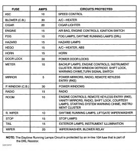

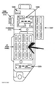

I have a 1997 ford escort station and the dash lights wont come on and neither will the park lights please tell me all the possibiliteis it could be
Dec 3, 2008 at 2:38 PM
DAVE H
  • 13,384 POSTS
check/replace meter fuse in under dash fuse box...located behind left kick panel ...
