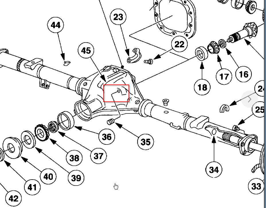

Rear differential leak. I know to use gear grease and a grease gun, but I'm not quite sure where to put it. I'm hoping someone could explain it to me and a picture would be even better. Thanks
Nov 4, 2007 at 9:25 AM
Depending on the year, it is either in the cover or it is on the housing shown in the attachment.

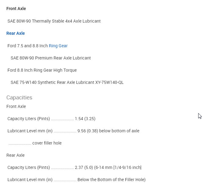

I also attached the type of oil that is needed. This is different the grease so make sure you are getting the correct product.
