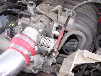

Mar 10, 2007 at 3:29 AM
I believe it is cable operated. I am attempting to attach pictures so you can verify that I am correct.
Mar 10, 2007 at 4:25 AM
its really hard to tell from that angle check right behind the throttle body and look for a cable from your pic it would be to the left of the throttle cable and back

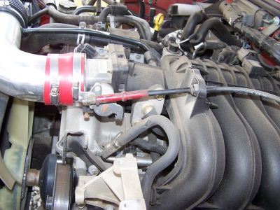

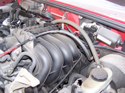

Mar 10, 2007 at 4:49 AM
Here are a couple more pictures. I'm sorry that I'm making it so difficult to help me, I'm just not very knowledgeable.

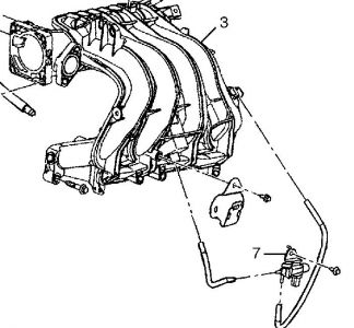

Mar 10, 2007 at 7:11 AM
ok i found a parts listing in my software , #7 is the actuator , see the vacuum hose running to the rear of the intake , there should be an arm back there to open and close the runner , check for vacuum on that side and for binding, and its no trouble , im here to help
Mar 10, 2007 at 7:46 AM
The hose that goes from the actuator to the back of the intake terminates, and then there is set of electrical wires connected at the same point. Also, it feels like there is a crack in that hose when it splits from the actuator.
Mar 11, 2007 at 6:21 AM
ah ha , losing vacuum , put your finger over it while its running and see if its pulling vacuum , and replace that hose , just take it up to the parts store and match it up , this may be your whole problem , wouldnt that be nice a 2 dollar fix , lemme know
Jim
Jim
Mar 11, 2007 at 6:26 AM
I replaced that hose, and disconnected my battery to reset the trouble code and it hasn't come back on since. You have to love a 72 cent hose fixing your problem. Thanks so much for your help.
