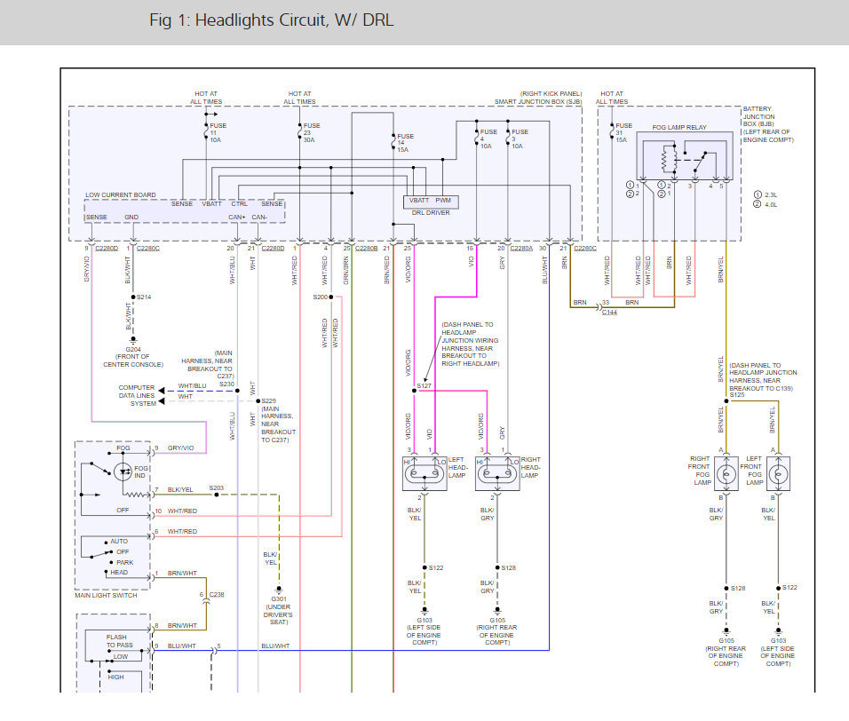

headlight wiring diagrams please?
2015 FORD RANGER
85,000 MILES • 2.2L • TURBO • 4WD • MANUAL
PIZZLED

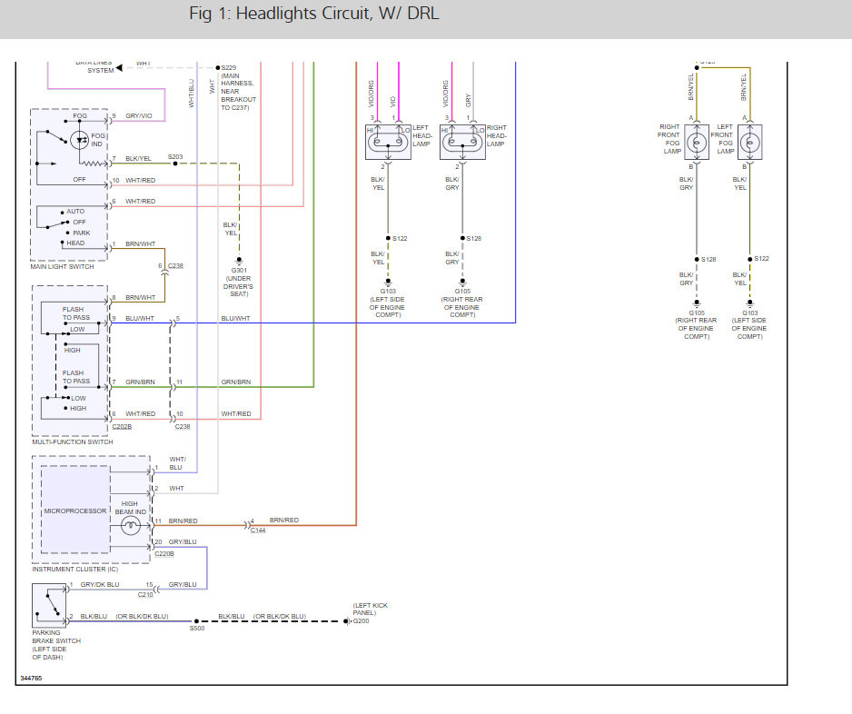

The H4 Low beam drivers side light only sends 7v through cable. The high beam on both sides and the low beam on passenger are working correctly. I can’t see a grounding problem as I have traced through. I have changed bulbs with new and switched to both sides. All fuses are fine but I can’t locate the relay if there is one to control the headlights. I’ve used the Forscan software to try and reset the BCM but that also does not work. I have read that the BCM has a circuit protection for the low beam that might have closed but have no idea if this can be reset. Truck is a Ford ranger limited t6 2015 pre facelift 2.2 UK version.

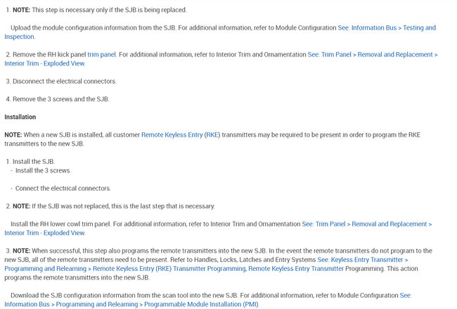

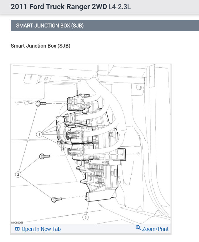

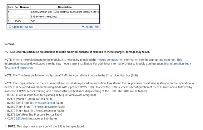

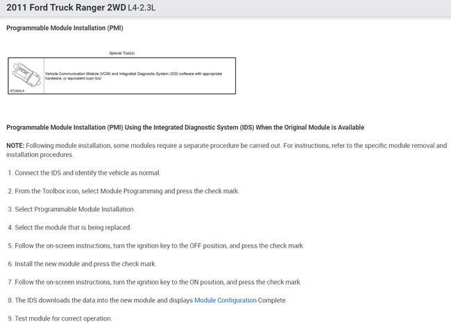

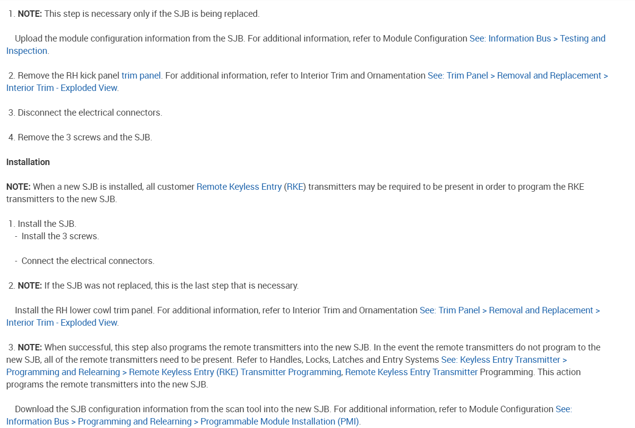

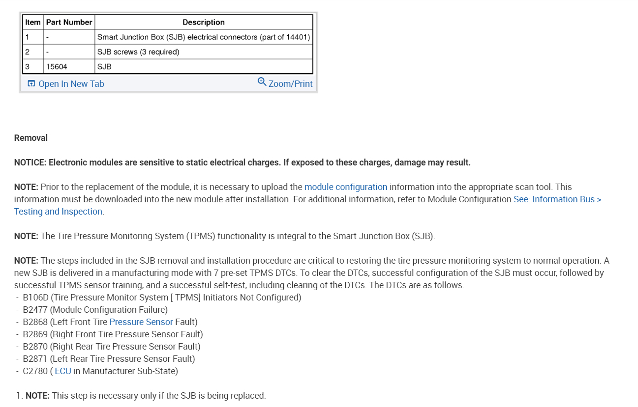

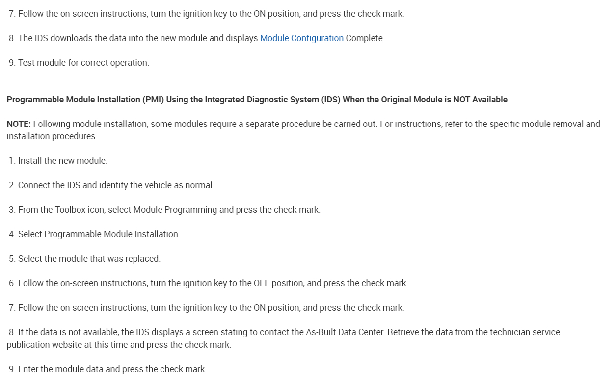

It sounds like the SJB (smart junction box) is out which is common. here is the headlight wiring diagrams so you can see how the system works nad which wires to test with a guide to test the wiring with how to replace the SJB (BCM) int he diagrams below:
