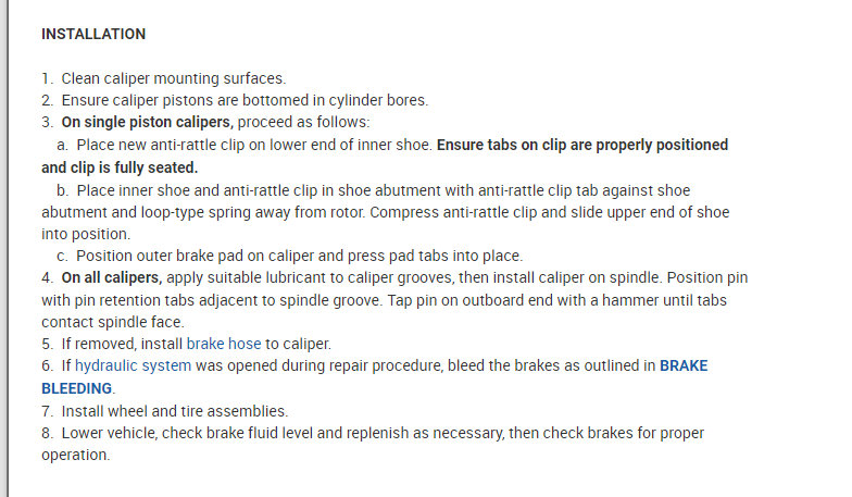

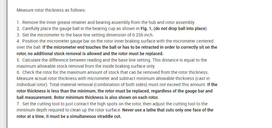

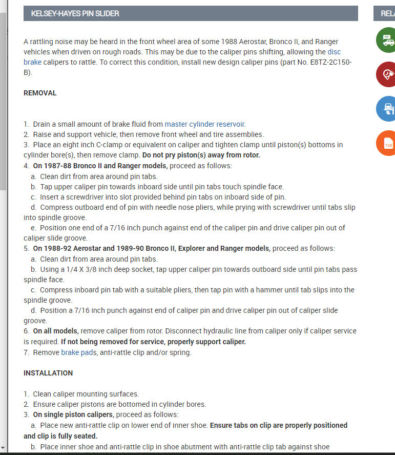

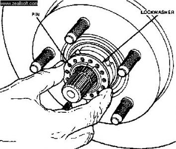

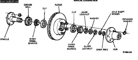

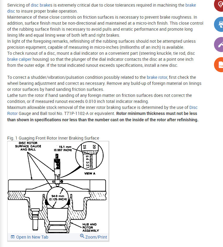

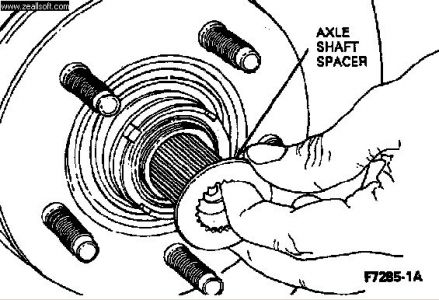

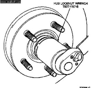

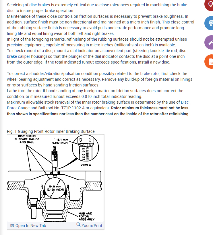

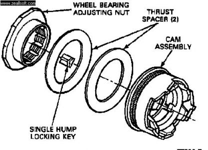

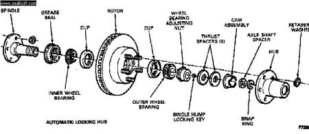

I am about to attempt a front brake job on my '92 Ranger, and am wondering if any special tools are required to remove/install caliper etc.. I plan on replacing the rotors and probably the calipers as well as repack the bearings. Firestone wanted 750 BUCKS to do all of the above. Thanks in advance for any help.

This is not that hard of a job so I would not pay that amount either.
Here are a couple guides that will help with this:
https://www.2carpros.com/articles/brake-caliper-replacement
I am attaching the process from the manual on how to replace the caliper and rotors. Please run through this material and let us know what you find. Thanks
