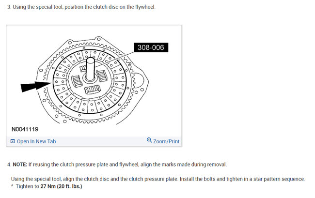

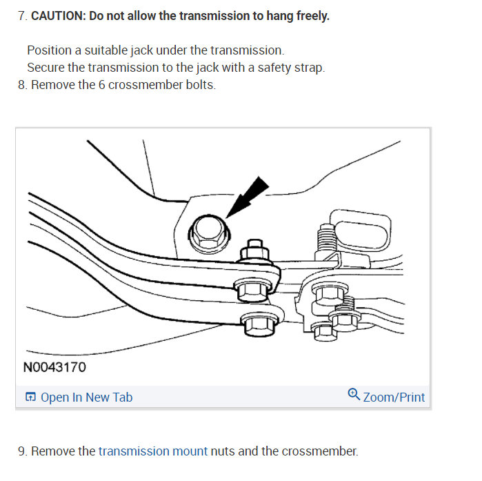

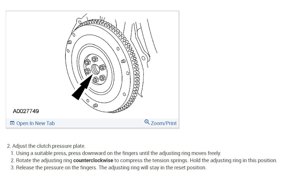

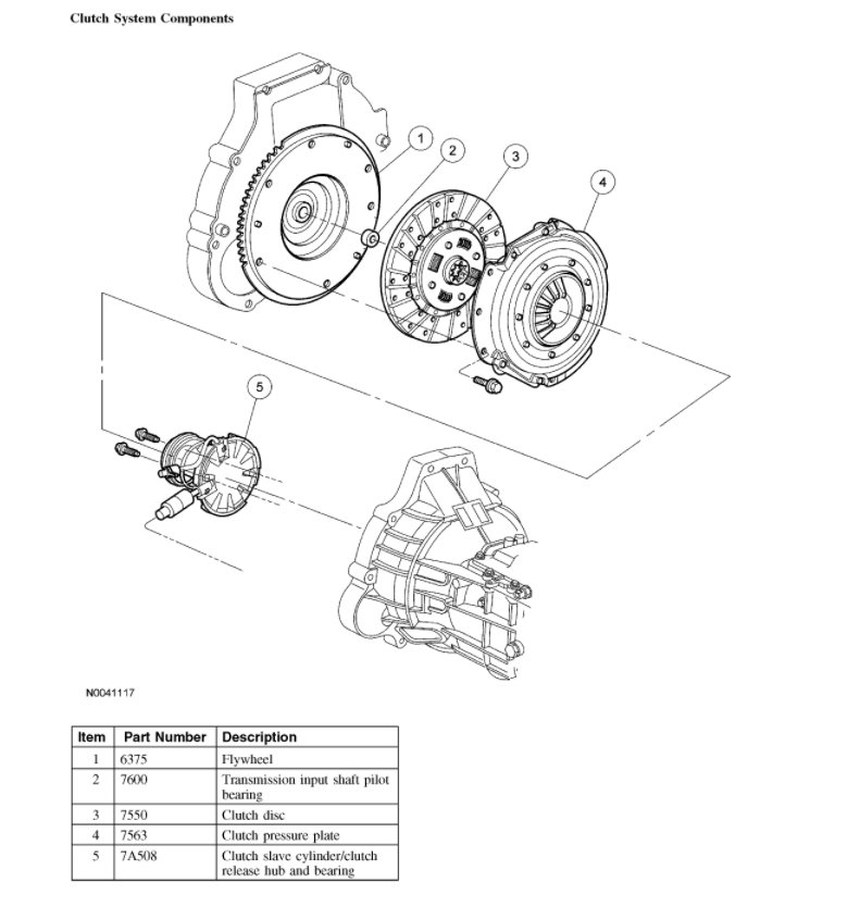

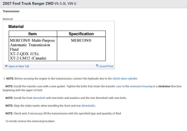

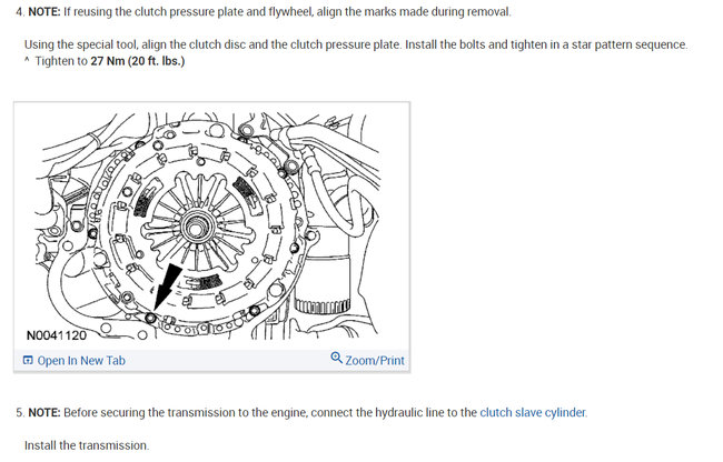

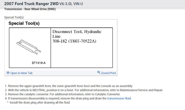

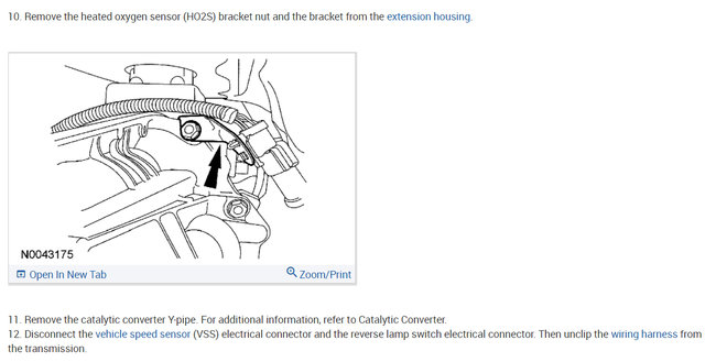

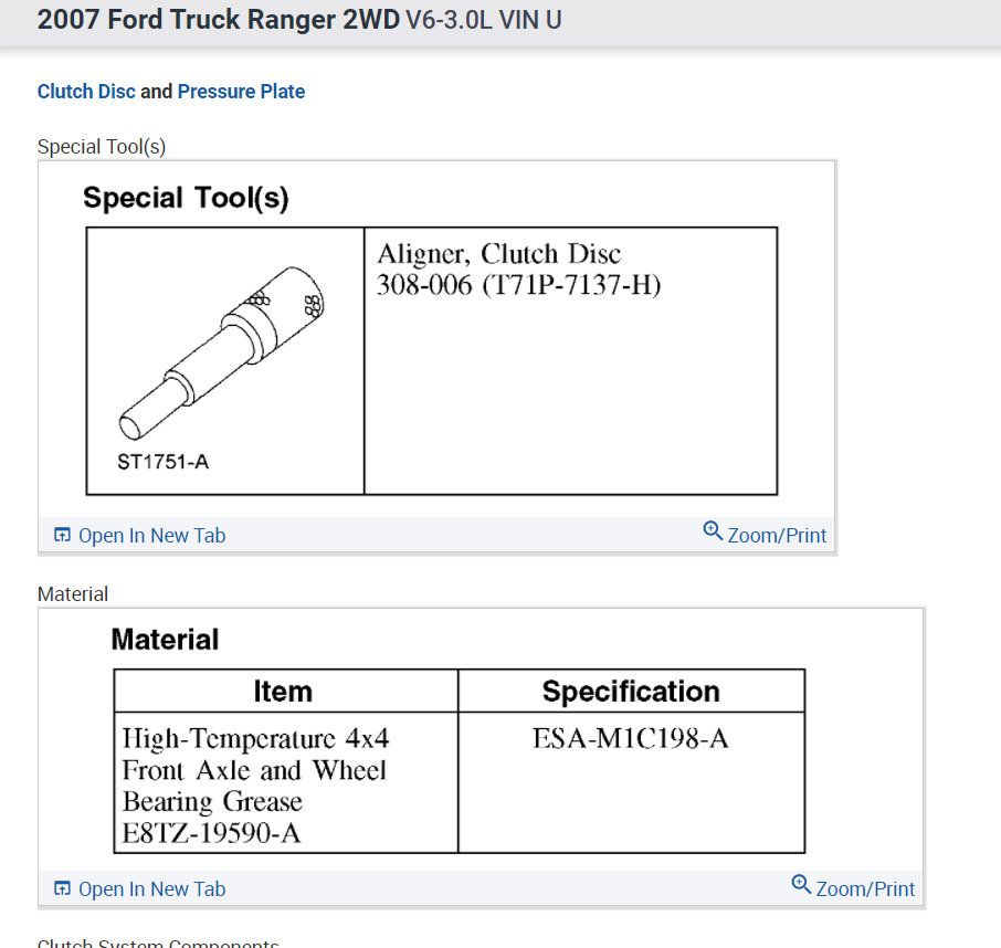

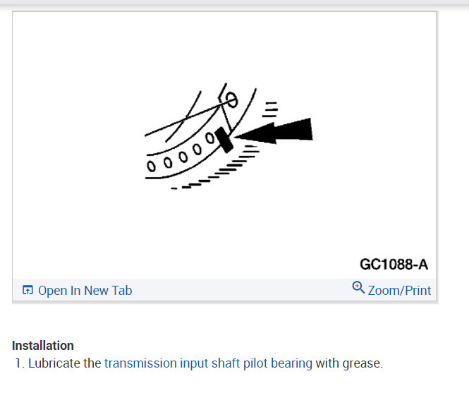

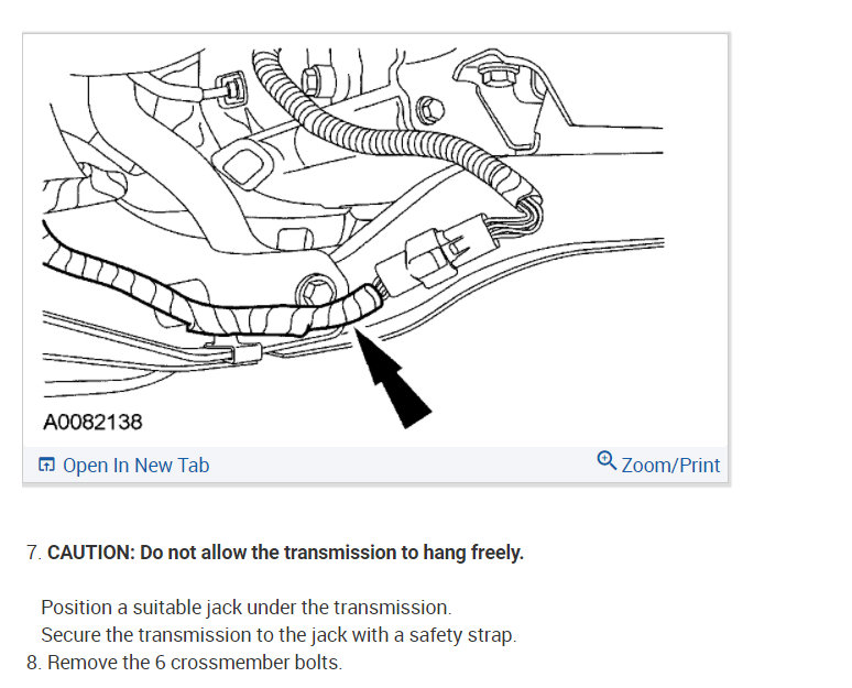

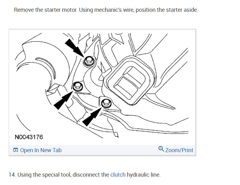

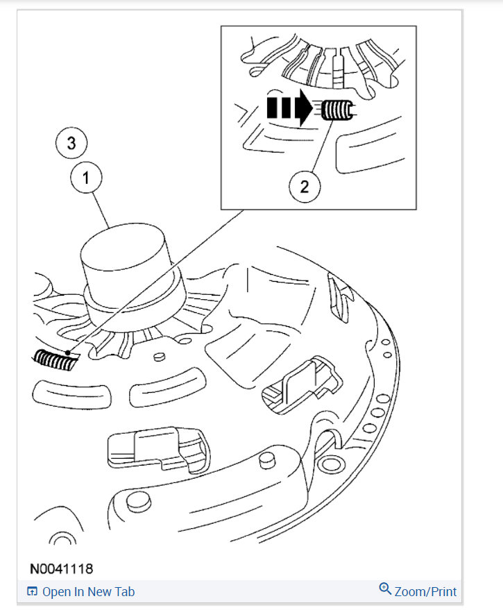

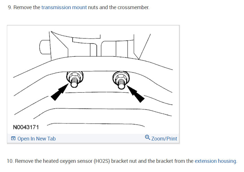

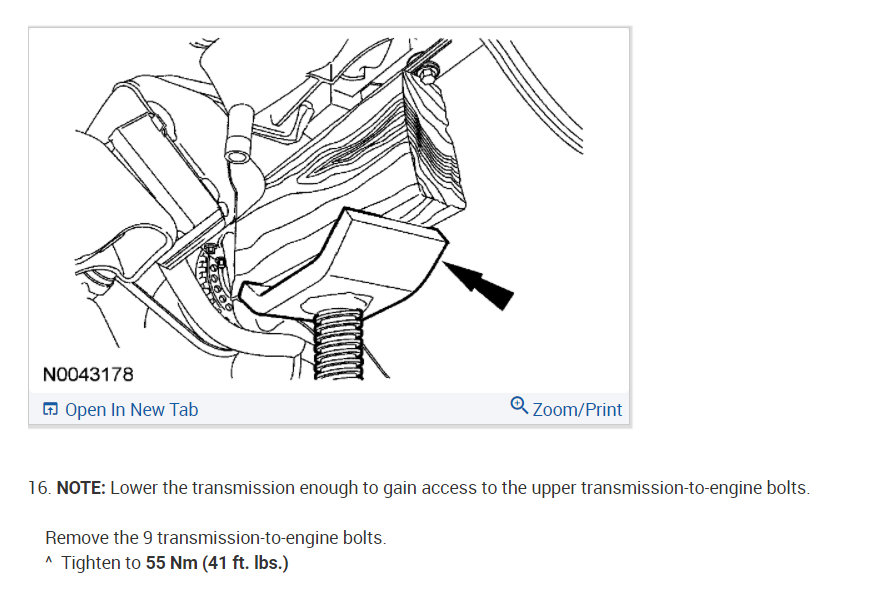

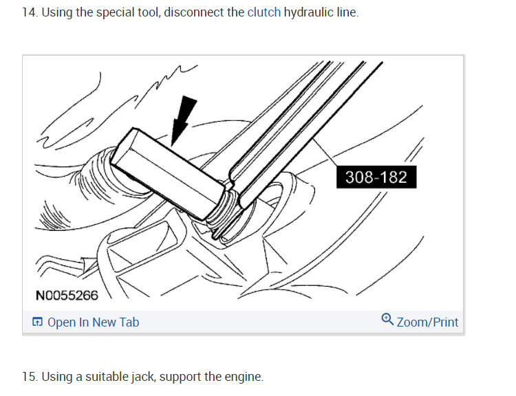

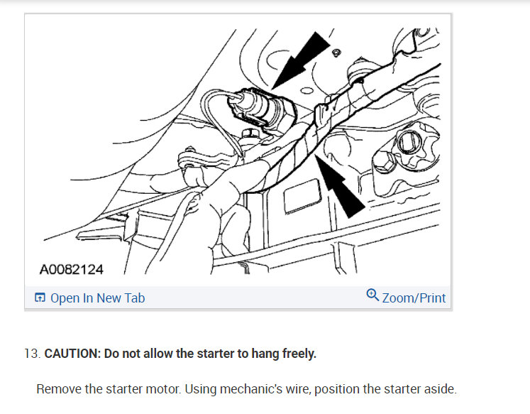

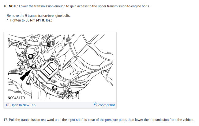

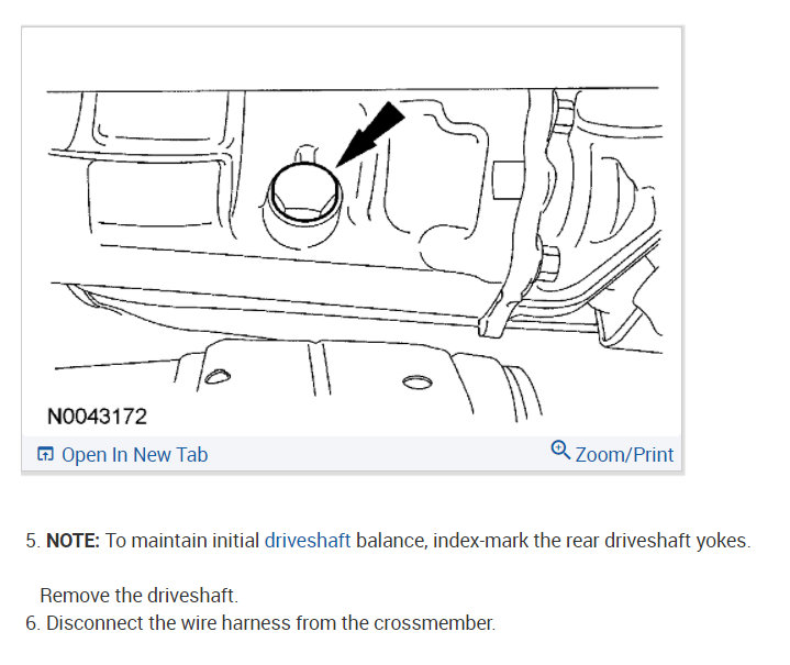

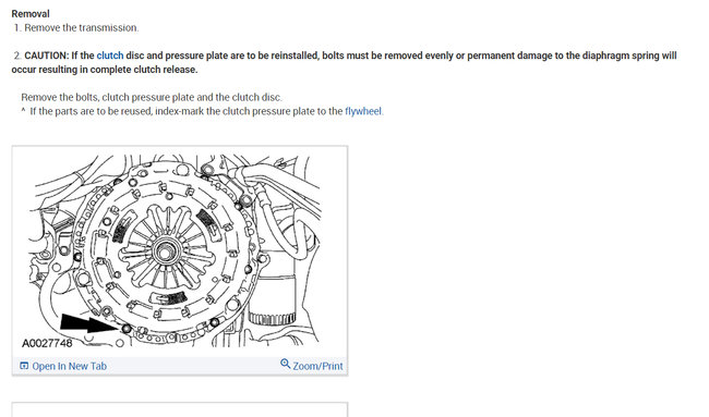

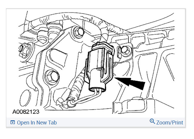

This video shows the job being done on a similar car but the process is the same with instructions in the diagrams below to show you how on your car:
https://youtu.be/JpzefqEeVGE RWD
Here is a guide to help you step by step with instructions in the diagrams below to show you how on your car:
https://www.2carpros.com/articles/how-to-replace-a-clutch
