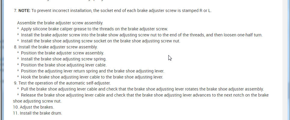

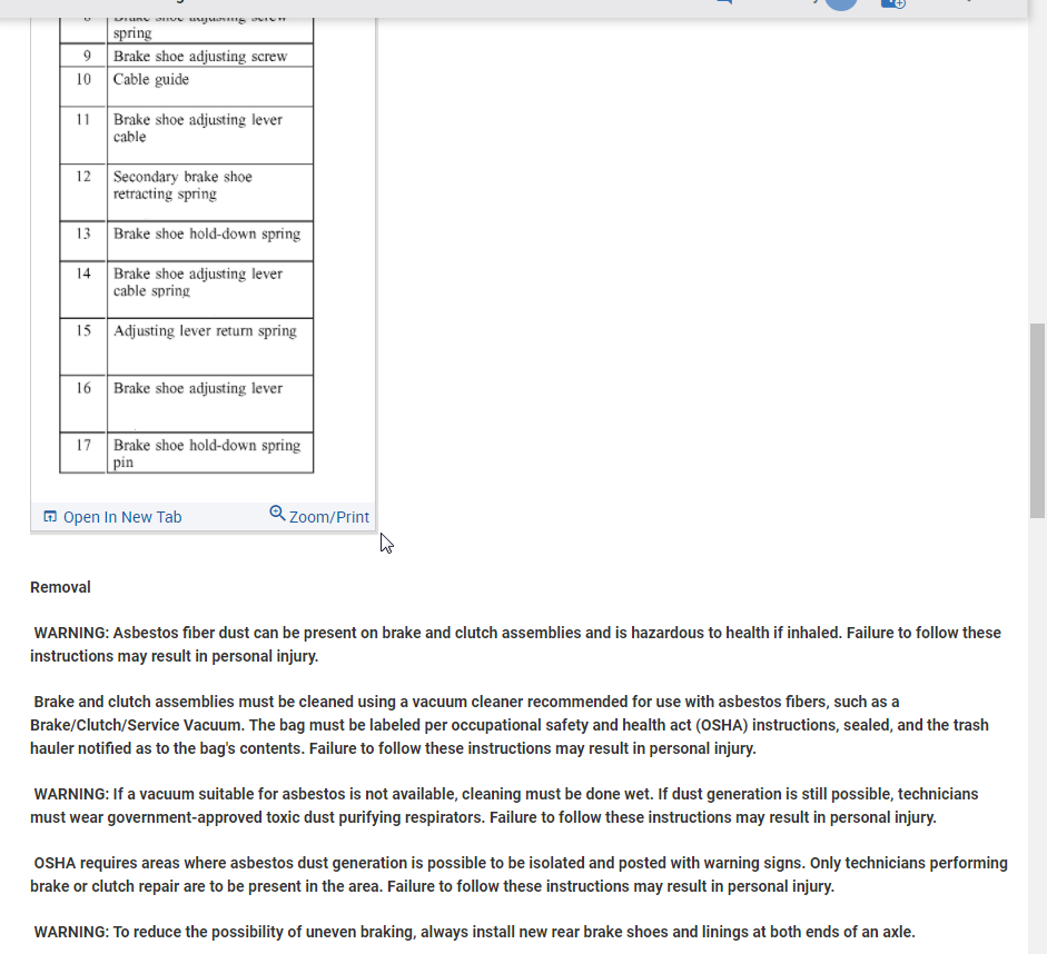

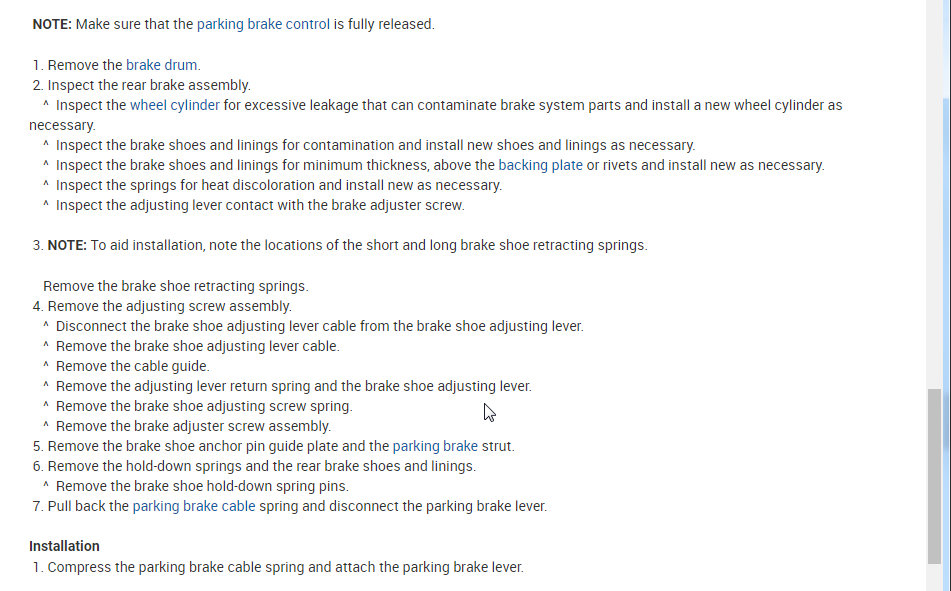

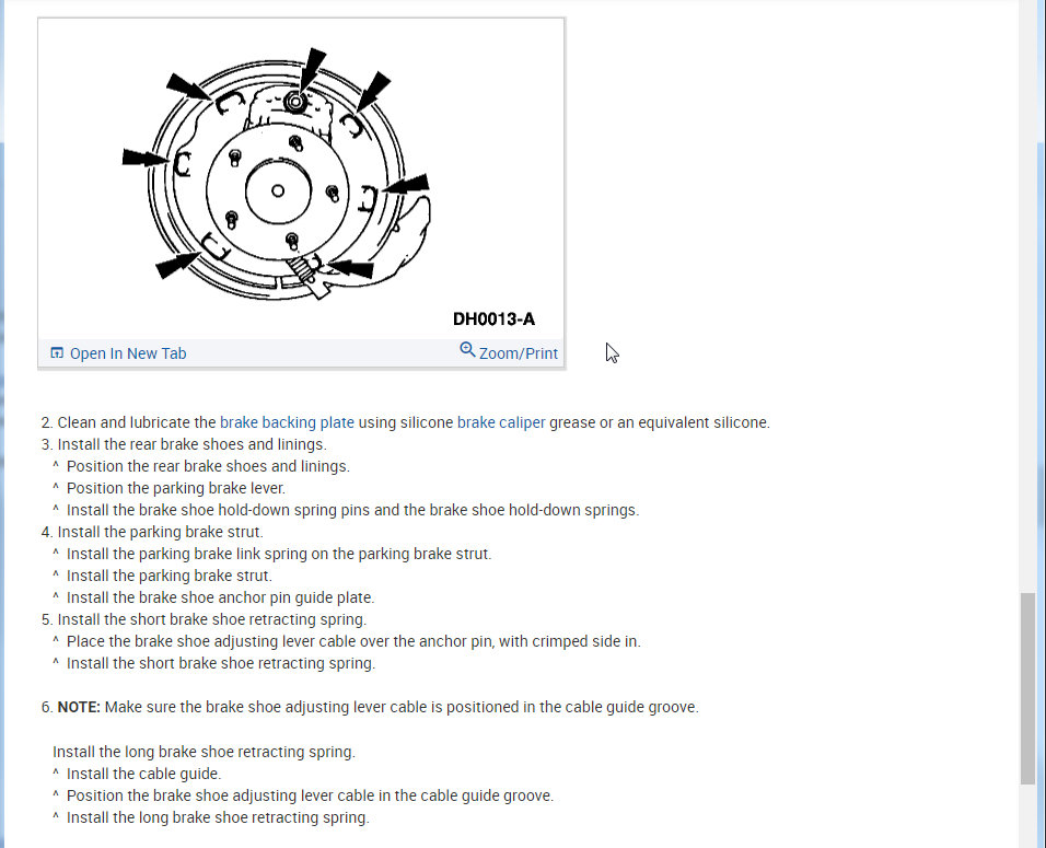

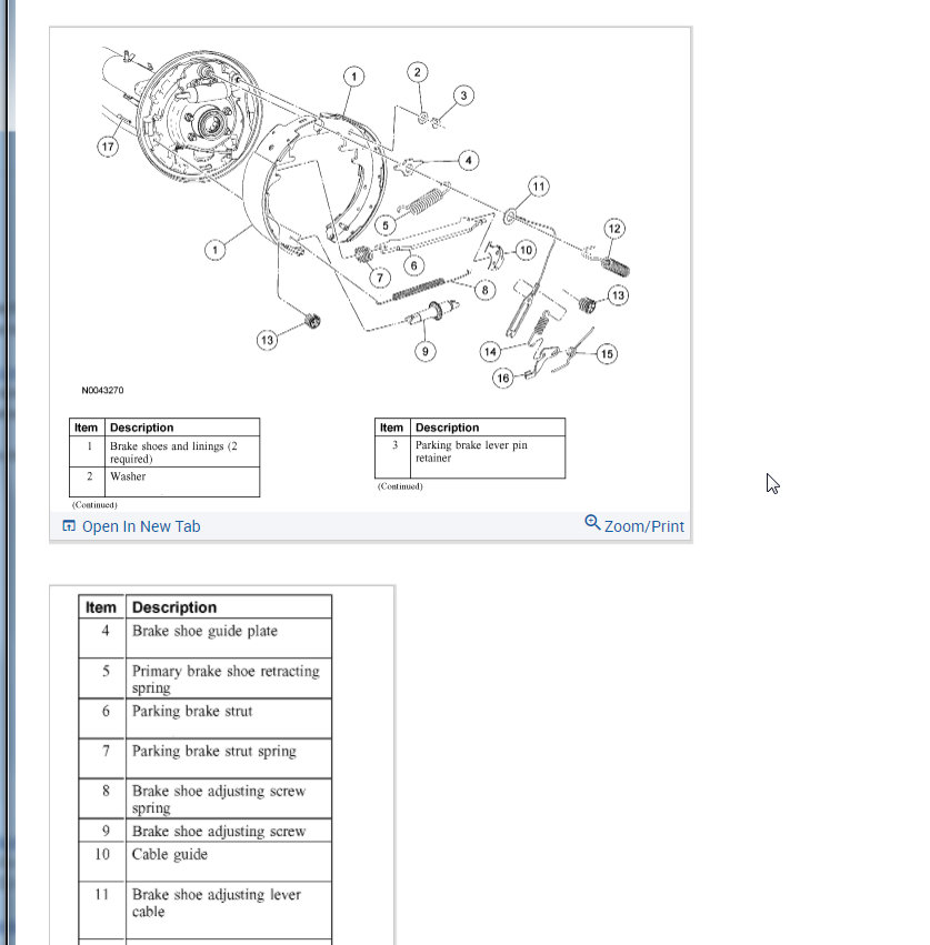

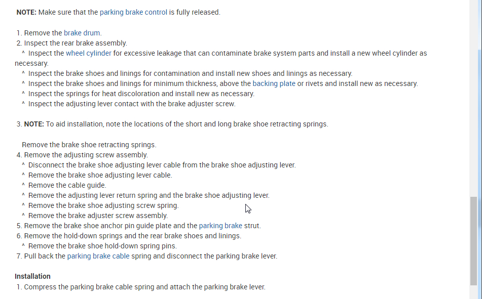

Below is the process from the manual that will help with this. Please let us know if you need more help or other info.
