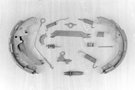

My girlfriend has not checked or thought about her brakes so naturally they have all but disappeared and now I am left with a task of putting them back together with out something to go by can some on help me there sure are a bunch of mystery clips springs and cables left over

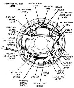

https://www.2carpros.com/forum/automotive_pictures/103836_0900823d800bcc16_1.jpg
https://www.2carpros.com/forum/automotive_pictures/103836_0900823d800bcc17_1.jpg
Left side

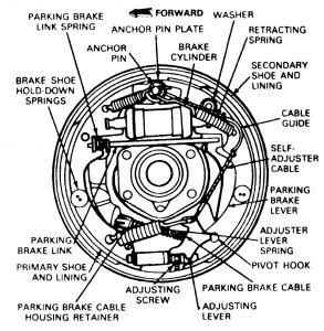

https://www.2carpros.com/forum/automotive_pictures/103836_0900823d800bcc18_1.jpg
right side
