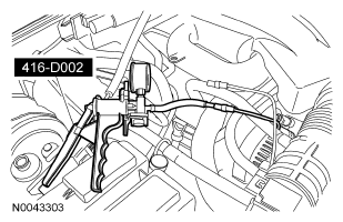

Hello, This guide can help with instructions below to show you how to fix it as well. https://www.2carpros.com/articles/air-vents-stay-in-the-defrost-position Pinpoint Test A: Incorrect/Erratic Direction of Airflow From Outlet(s) Normal Operation Under normal operation, the function selector switch is provided vacuum from the engine. When a position is selected, vacuum is applied to the desired vacuum control motor that is connected to the mode door you want to control. Possible Causes Function selector switch Heater control valve Vacuum control motor Stuck or bound linkage or door Leaking or plugged vacuum hose PINPOINT TEST A: INCORRECT/ERRATIC DIRECTION OF AIRFLOW FROM OUTLET(S) A1 CHECK THE SYSTEM AIRFLOW Key in ON position. With the engine running, adjust the blower motor speed to maximum. Check for correct airflow in each function selector switch position at engine idle and during engine acceleration. Is there airflow only from the defroster outlets under all conditions? Yes: GO to A2. No: GO to A8. A2 CHECK THE VACUUM SUPPLY LINE FOR OBSTRUCTIONS NOTE:The 2 vacuum lines to the vacuum reservoir tank are not interchangeable. Fig. 4: Disconnecting Vacuum Lines From Vacuum Reservoir Tank
https://images.2carpros.com/forum/automotive_pictures/266999_4_1.png
Disconnect the vacuum lines from the vacuum reservoir tank. Connect the special tool to the vacuum supply line and try to pull a vacuum. If the special tool can pull a vacuum, the vacuum supply line is plugged. If the special tool pulls a partial vacuum, the vacuum supply line is restricted.
https://images.2carpros.com/forum/automotive_pictures/266999_5_1.png
Is the vacuum supply line plugged or restricted?

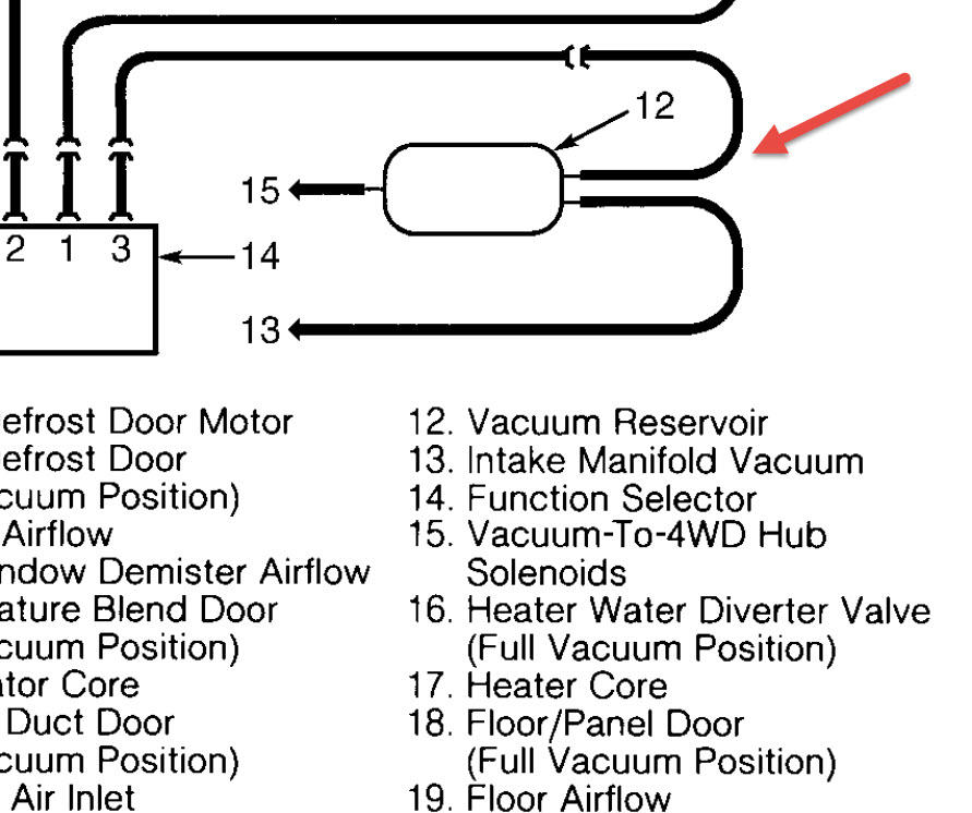

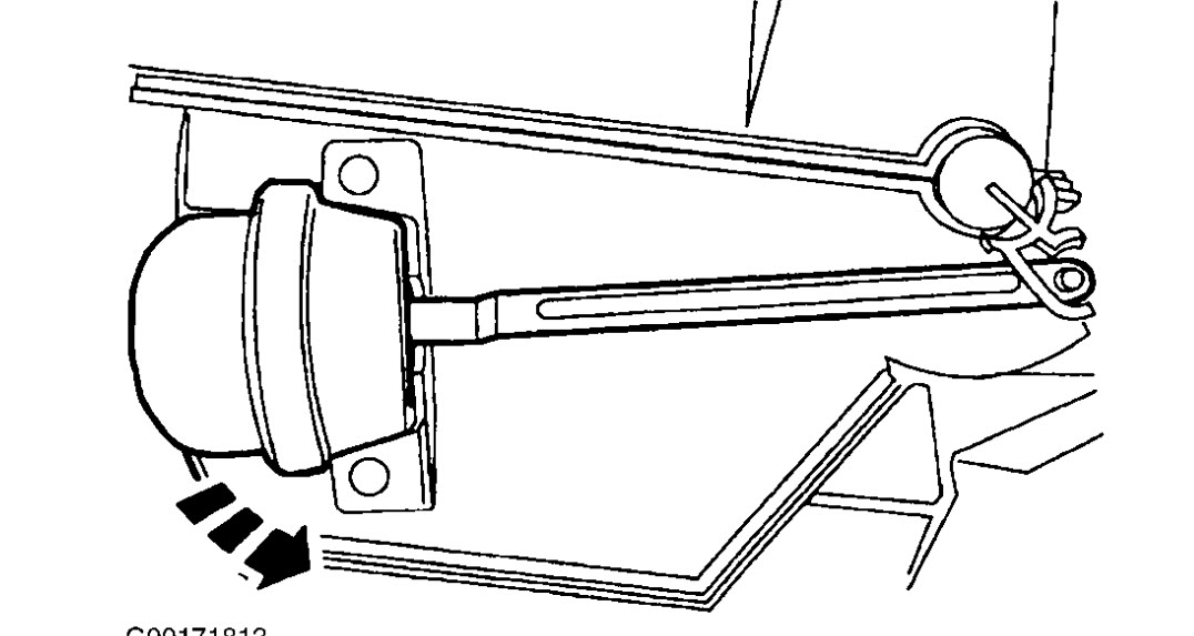

check for a vacuum leak first then check to see if the ocntrol head is sending vacuum to one of the motors on the heater. i think it is on the drivers side. the pic shows what it looks like. the door may be stuck as well so see if it will move with it on heat.
This guide will help you
Check out the diagrams (Below). Please let us know what you find.

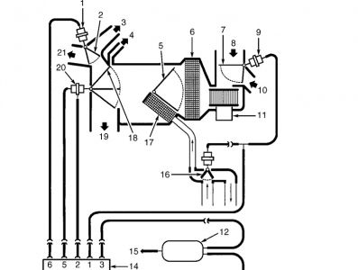

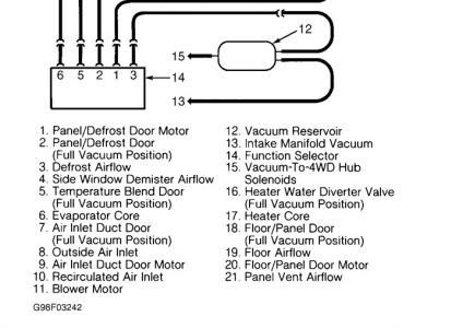

the vacuum line supplies vacuum to heater control so it will switch the vacuum motors to the desired position. This guide will help you fix it

That's for the electronic actuators. If you have the more common, and more reliable vacuum actuators, those will be spring-loaded to default to the defrost position when vacuum is lost, as in a broken or disconnected vacuum hose. That's for safety. Your feet might freeze, but your windshield will be clear. Look on the vacuum hose routing diagram on the sticker under the hood to see if they show a small vacuum hose going to a storage canister, then through the firewall.
