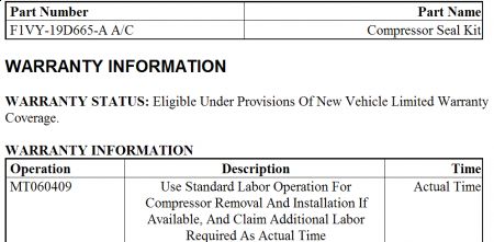

There is a technical bulliten about 2002-2006 Rangers, the A/C compressor shaft seal leaks freon, and needs to be replaced. Here's the TSB: A/C COMPRESSOR NOT OPERATIONAL / LOW FREON - SHAFT SEAL LEAKS TECHNICAL SERVICE BULLETIN Reference Number(s): 06-4-9,  Date of Issue:   March 6, 2006 Related Ref Number(s): 06-4-9 ARTICLE BEGINNING ISSUE Some 2002-2006 vehicles equipped with an FS-10 A/C compressor may experience a non operational A/C compressor due to a low freon level caused by a leaking shaft seal. ACTION Replace the A/C compressor shaft seal following the Service Procedure. SERVICE PROCEDURE If the shaft seal on the front of the A/C compressor is leaking, replace the shaft seal (F1VY-19D665- A) and not the compressor assembly. Replacing the shaft seal should correct the leaking condition. When replacing the seal, follow the procedure outlined in Workshop Manual, Section 412-03. PARTS INFORMATION FORD: 2003 Escort; 2003-2006 Focus, Mustang, Taurus; 2003 Explorer Sport, Windstar; 2003-2005 Excursion, Explorer Sport Trac; 2003-2006 Escape, F-150, F-Super Duty, Ranger; 2004-2006 Freestar; 2006 Low Cab Forward LINCOLN: 2002 Blackwood; 2006 Mark LT MERCURY: 2003-2005 Sable; 2004-2006 Monterey; 2005-2006 Mariner.
https://images.2carpros.com/forum/automotive_pictures/62217_1_71.jpg
The other problem you had, air changing to defrost, means there is a vacuum leak in either a line, or the control head, this could allow the temperature blend door to not close the heat off fully during A/C operation...
