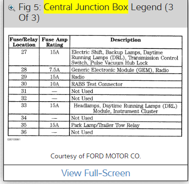

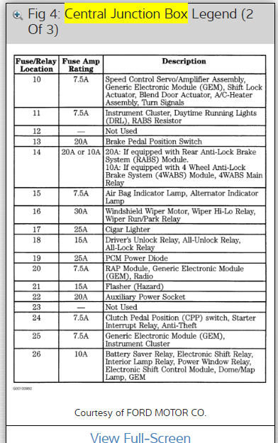

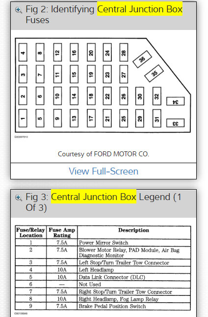

HMAC300
  • 48,601 POSTS
Fuse 10 inside truck fuse box
