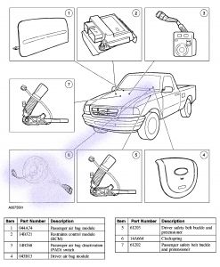

i have a 2005 Ford Ranger with 12200 miles on it that was rolled into a ditch and the gauge cluster was ruined, so i replaced that. but from the time it rolled, to this day the cruise control and horn do not work. how can i fix it?

did the airbag deploy?
Sep 7, 2007 at 8:36 AM
PGFIDDY
no, the airbags did not deploy.
Sep 7, 2007 at 2:42 PM
MERLIN2021
  • 17,250 POSTS
Probably need a new clockspring, this is the only comon part to both SRS and horn circuits, except the steering wheel of course! Your call! my money's on the clockspring.....

how much do you think a new clockspring would cost? and where exactly is it located?

Suggested Repair
Replace the steering-wheel clockspring, the shared component in the horn and cruise-control circuits. Have the airbag system checked before any steering-wheel work.
Conversation Summary
A 2005 Ford Ranger rolled into a ditch and later had its ruined gauge cluster replaced, but the horn and cruise control still do not work. The airbags did not deploy. The expert identifies the clockspring as the likely common failure point for both circuits.
