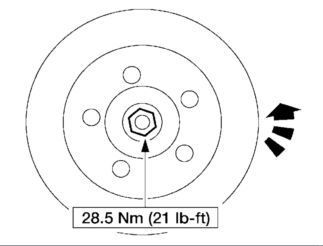

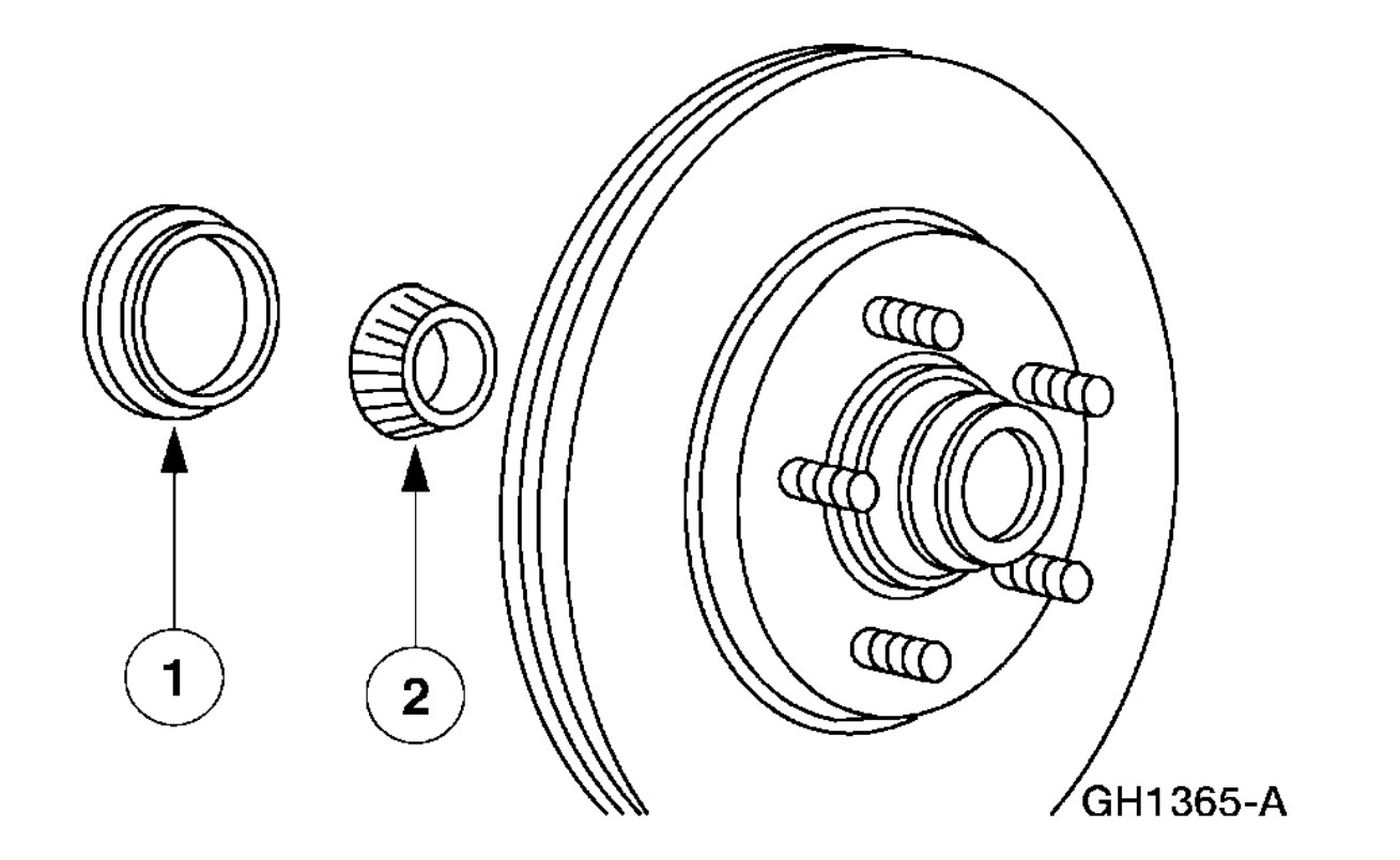

Hello, I have a 05 ranger 3.0 litre motor, and when I come to a stop the pedal pulsates.

I attached the procedure for replacing the pads and rotors along with a guide for you.

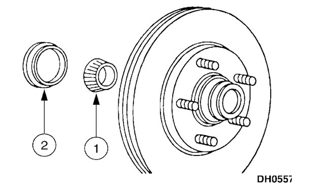

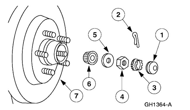

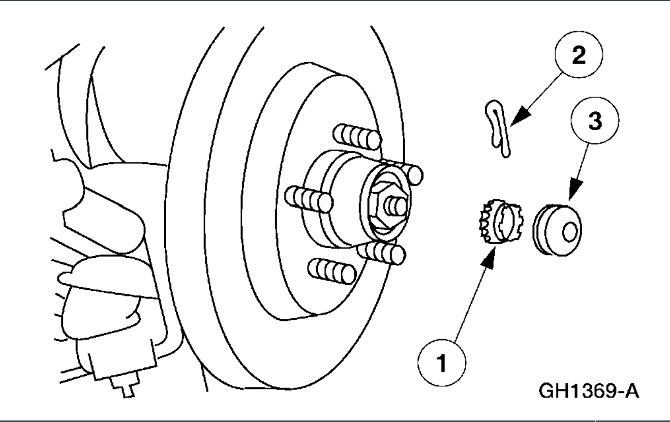

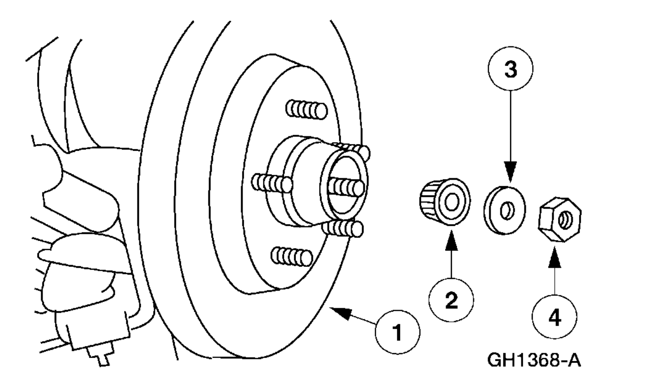

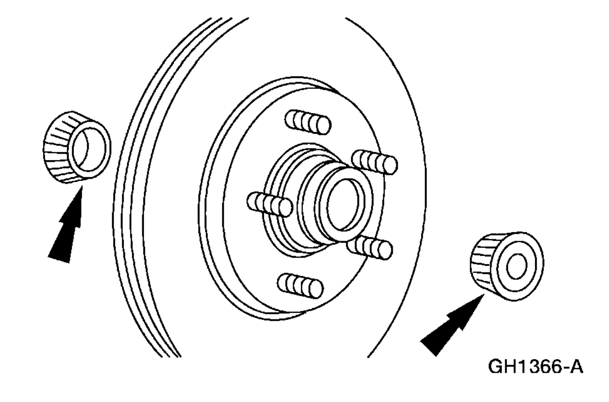

REMOVAL AND INSTALLATION

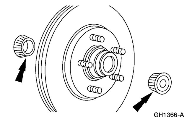

Disc
1. Remove the front disc brake caliper anchor plate.
2. On 4x4 vehicles, remove the brake disc.

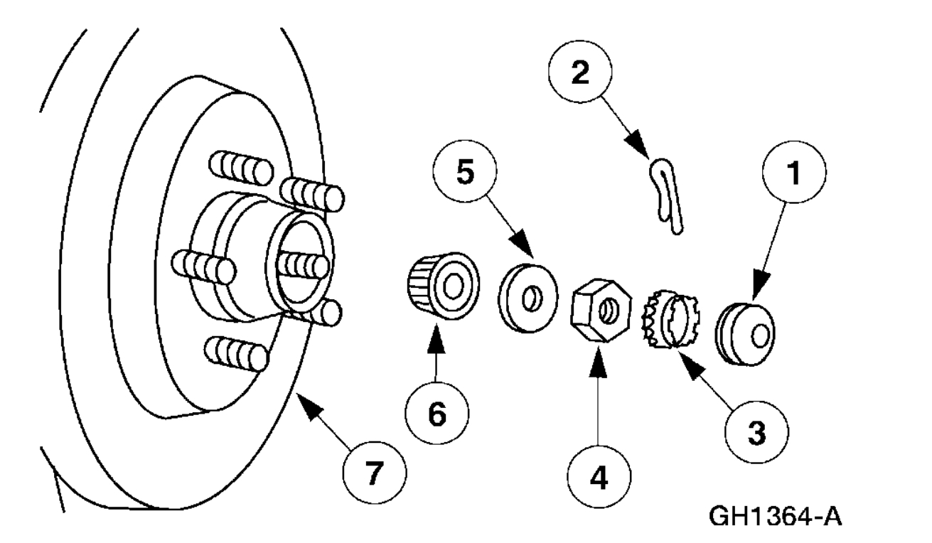

3. On 4x2 vehicles, remove the brake disc and hub as follows:
1 Remove the hub grease cap.
2 Remove the cotter pin.
3 Remove the nut retainer.
4 Remove the spindle nut.
5 Remove the front wheel outer bearing retainer washer.
6 Remove the outer front wheel bearing.
7 Remove the brake disc and hub.
4. If necessary on 4x2 vehicles, resurface the brake disc and hub using a hub mounted brake lathe. Follow the lathe manufacturer's instructions.

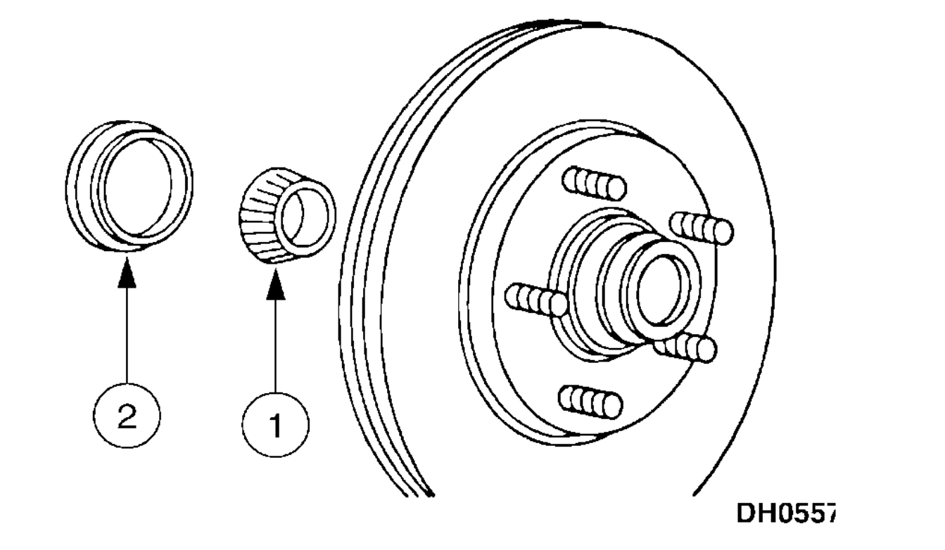

1 Remove the wheel hub grease seal.
2 Remove the front wheel bearing.
Installation

4. On 4x2 vehicles, install a new wheel hub grease seal.

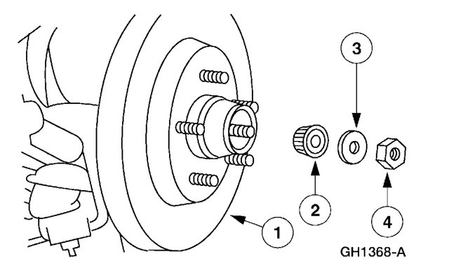

1 Install the inner front wheel bearing.
2 Install a new wheel hub grease seal.

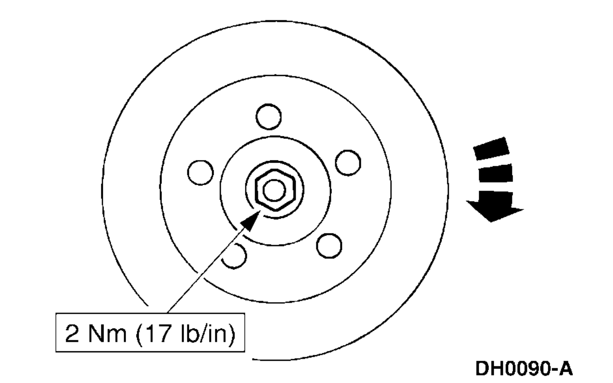

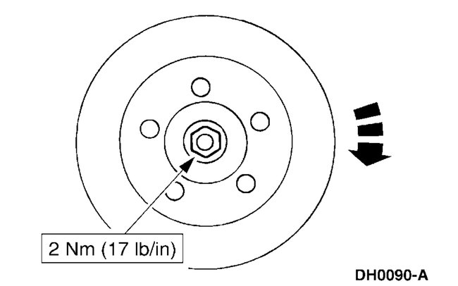

5. On 4x2 vehicles, install the brake disc and hub.
1 Position the brake disc and hub.
2 Install the outer front wheel bearing.
3 Install the front wheel outer bearing retainer washer.
4 Install the spindle nut.

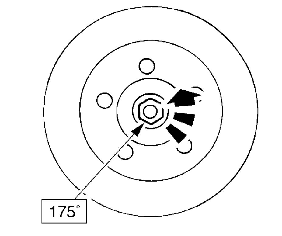

6. Tighten the spindle nut while rotating the brake disc and hub.
7. Loosen the spindle nut.
8. Tighten the spindle nut while rotating the brake disc and hub.
9. On 4x2 vehicles, install the following components:
1 Install the nut retainer.
2 Install the cotter pin.
3 Install the hub grease cap.

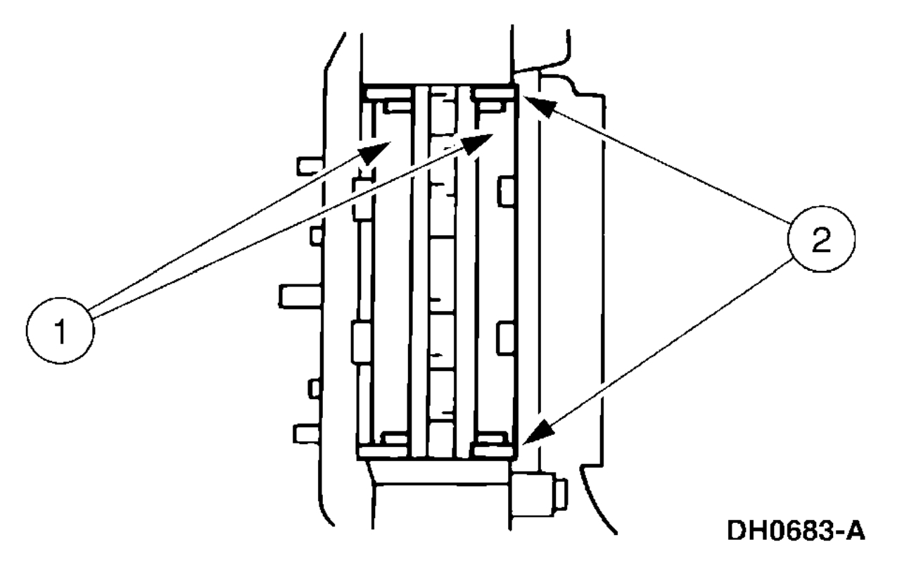

Pads
Removal
1. Raise and support the vehicle.
2. Remove the wheel and tire assembly.
3. CAUTION: Replace the pads if worn to or past the specified thickness above the metal backing plate or rivets. Replace the pads in complete axle sets.
Inspect the pads for wear or contamination.

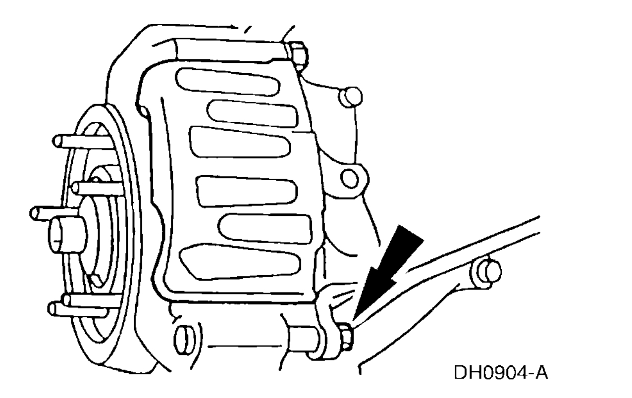

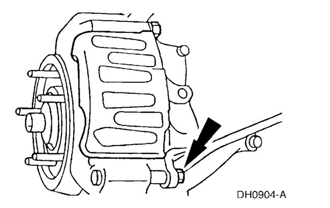

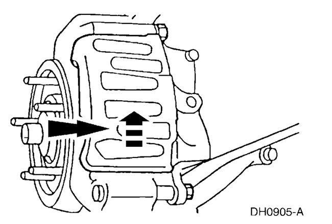

4. Remove the lower caliper bolt.
5. Rotate the disc brake caliper upward.

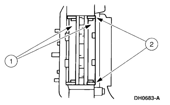

6. Remove the pads and the stainless steel slippers.
1 Remove the pads.
2 Remove the stainless steel slippers.
^ Discard the slippers.
7. Measure the brake disc and hub for minimum thickness.
^ Replace the brake disc and hub if not within specification.
8. If necessary, resurface the brake disc. Ford recommends on-vehicle rotor machining. Follow the lathe manufacturer's instructions.

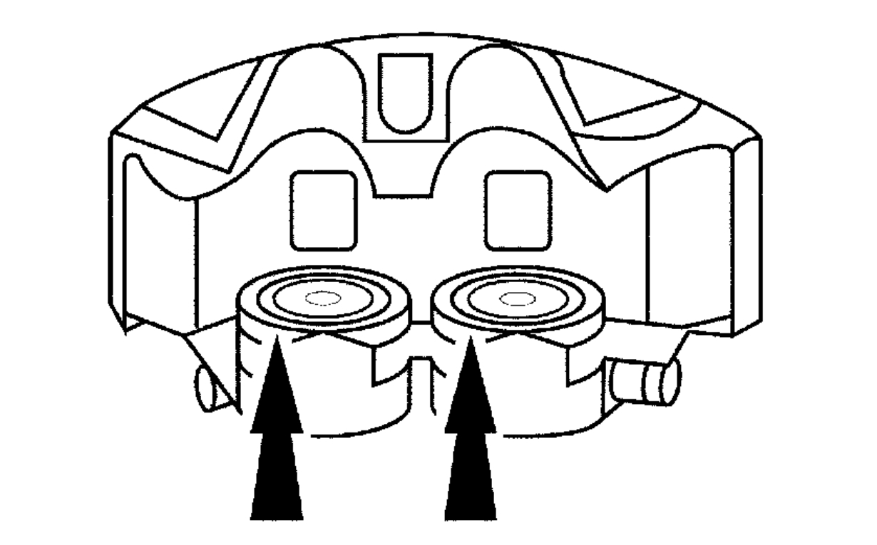

9. Inspect the disc brake caliper for leaks.
^ If leaks are found, disassembly is required.
