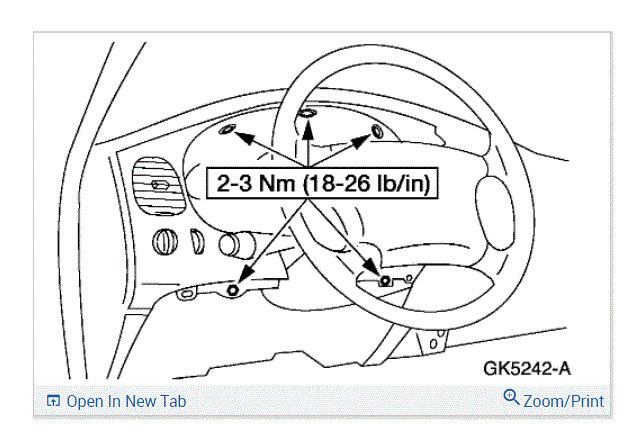

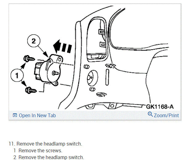

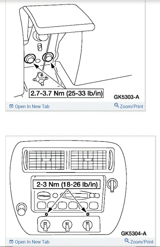

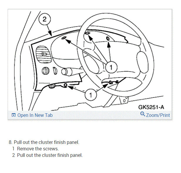

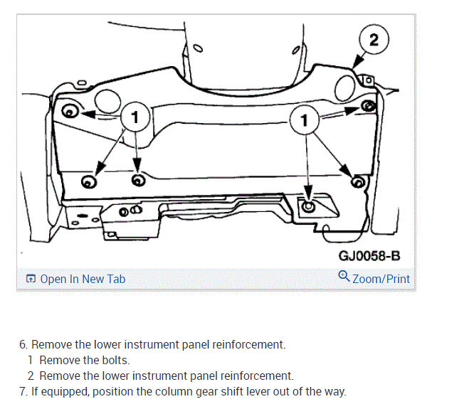

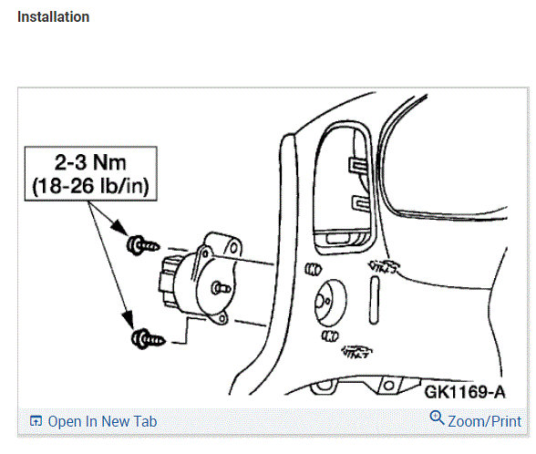

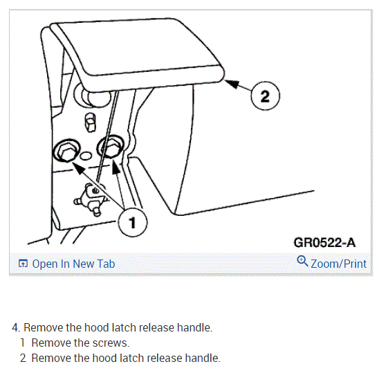

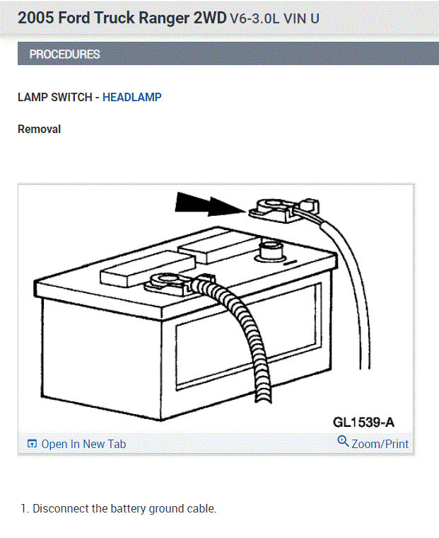

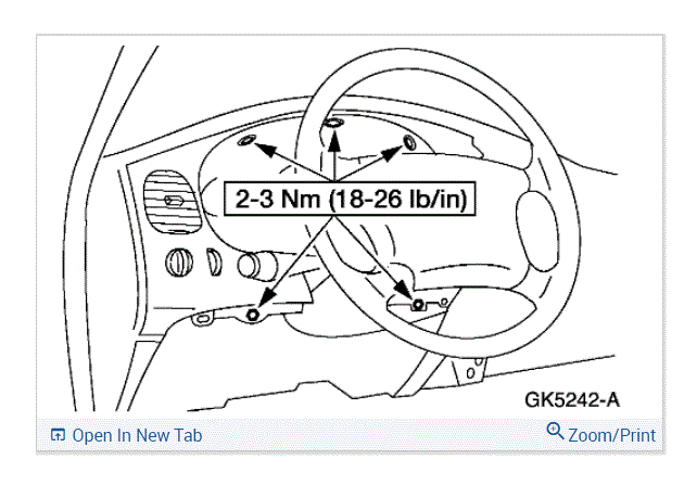

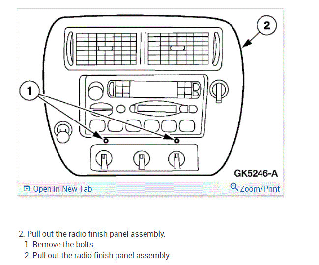

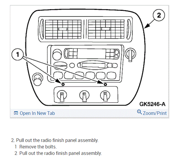

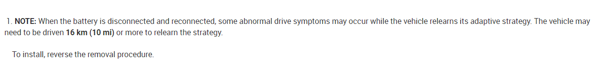

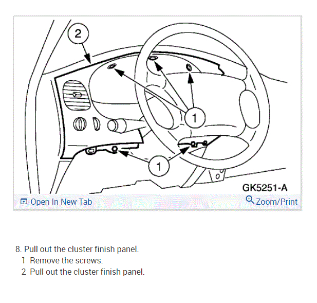

when you turn on the headlight switch the dash lights go out along with the signals and the wipers, i need to replace the headlight switch.
Dec 4, 2008 at 9:57 PM
  • 110,194 POSTS

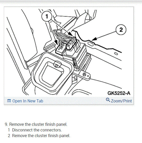

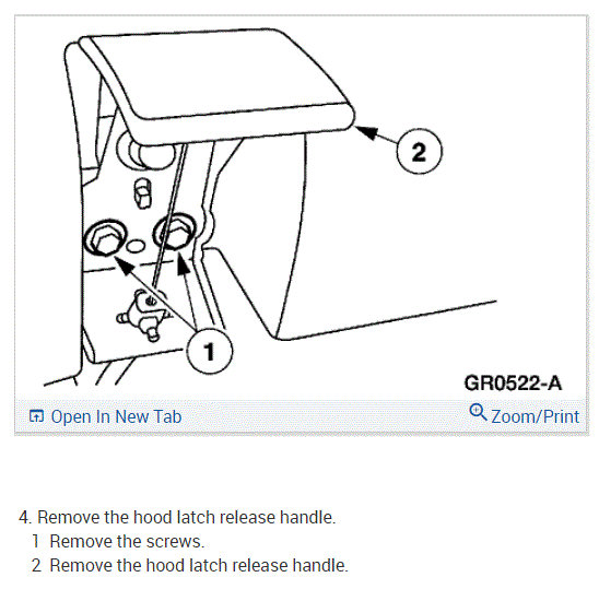

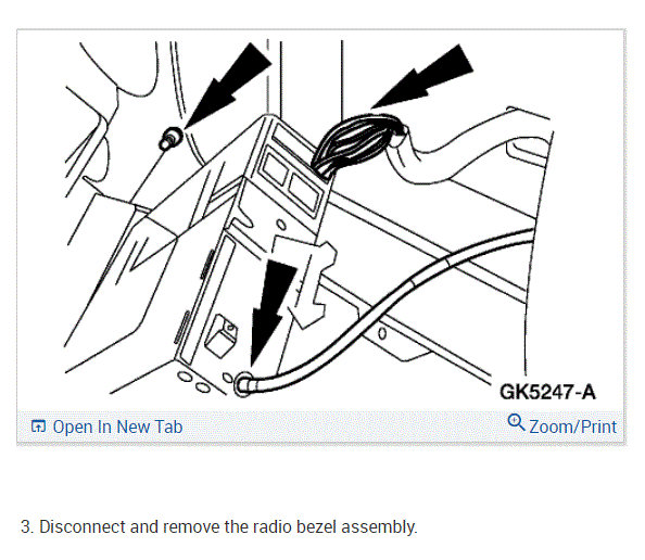

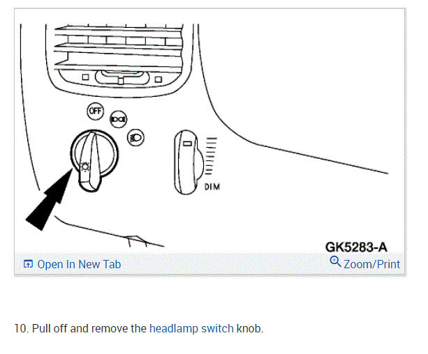

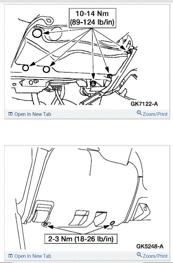

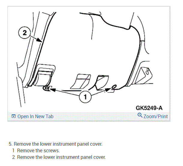

Replacing the headlamp switch on the truck is simple. The hard part is getting to it. Regardless, if you take your time, you'll be fine.
Here is a link you may find of interest. It discusses in general how the headlamp switch works.
https://www.2carpros.com/articles/how-a-headlight-switch-works
If you look at the attachments below, they provide the directions specific to your vehicle for the replacement of the switch.
