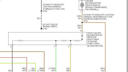

heater blower works only on high speed. where is the resistor in this system located and how do i replace it?

All you have to do is disconnect it -See below for location
https://images.2carpros.com/forum/automotive_pictures/12900_resistor_15.jpg
