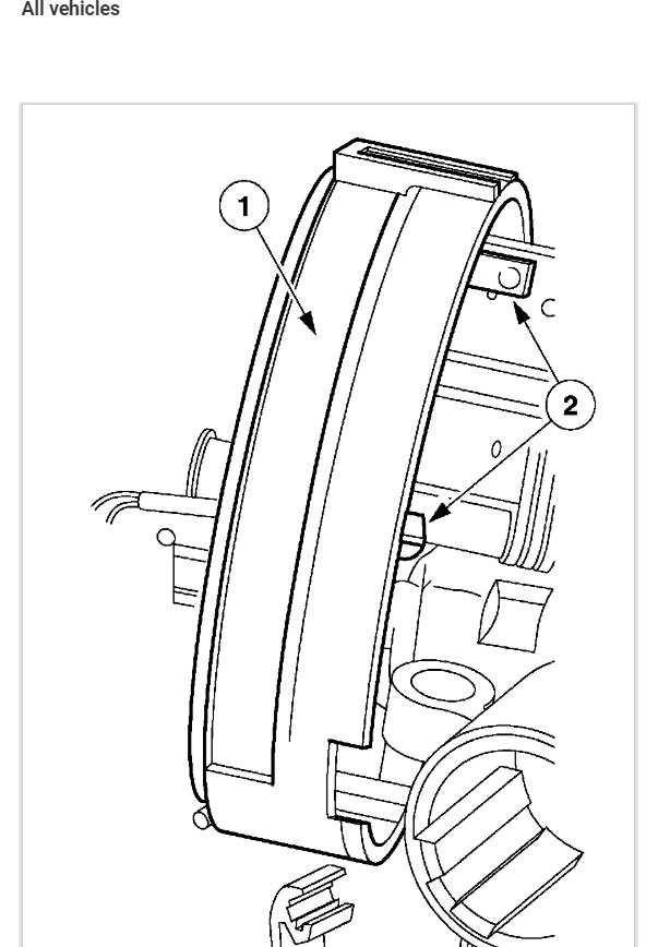

The cover plate on the console/dash where the airbag key is located was pulled off. It was just the cover plate and not the airbag switch on the console but immediately afterward, the airbag light is blinking. Any ideas what might have happened and how to fix it?

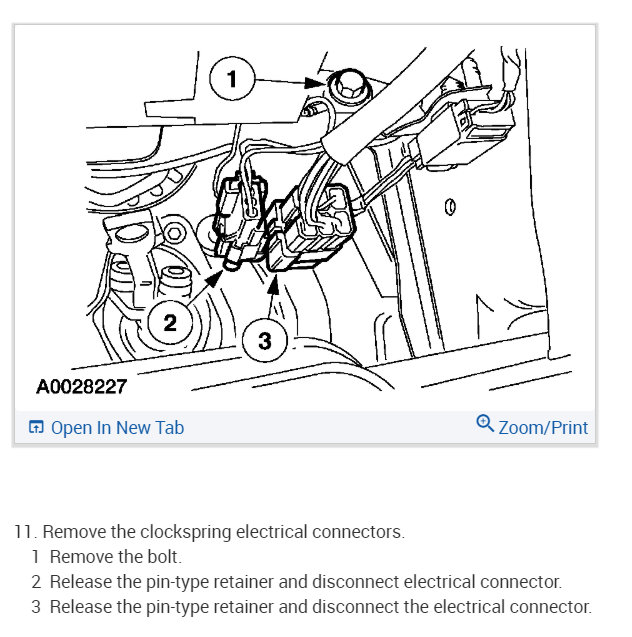

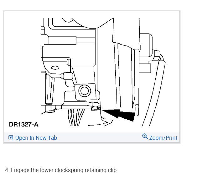

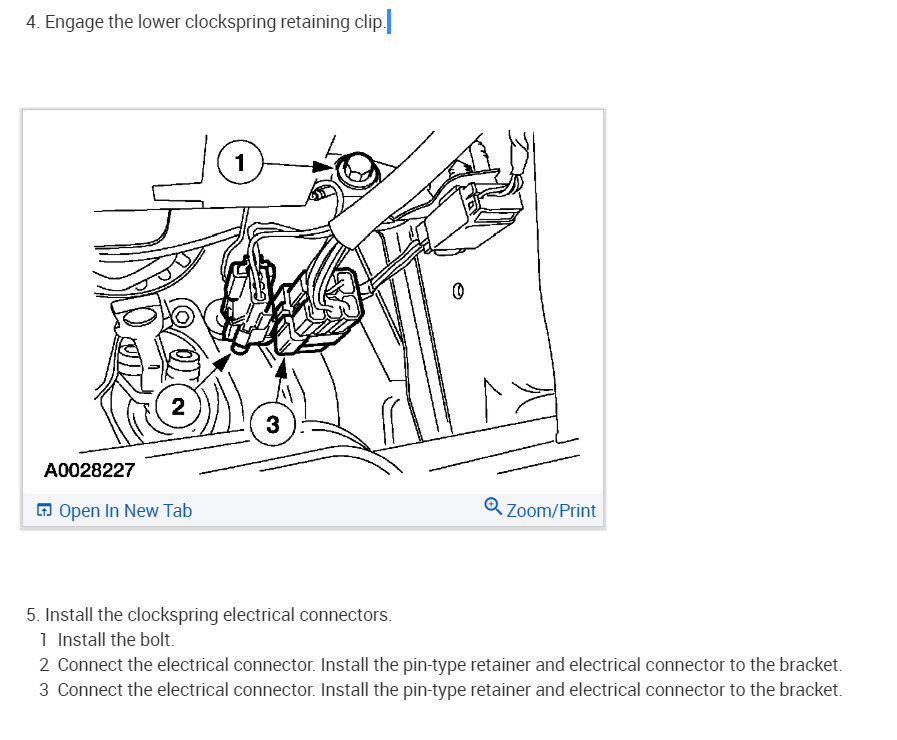

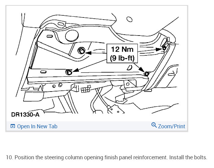

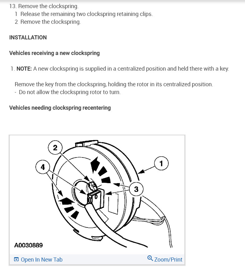

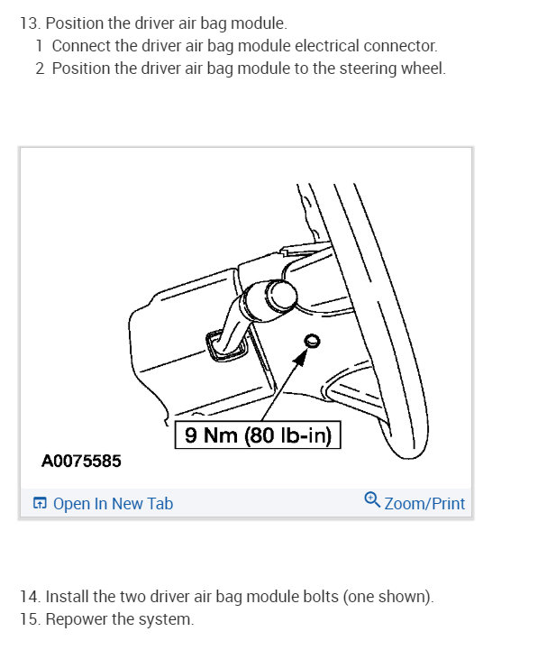

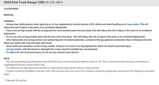

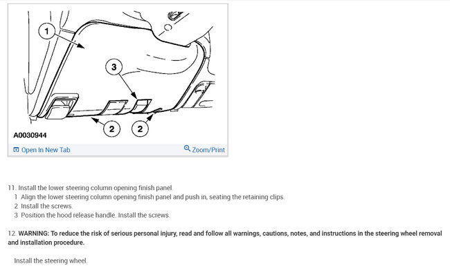

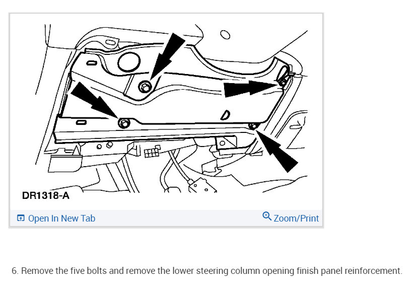

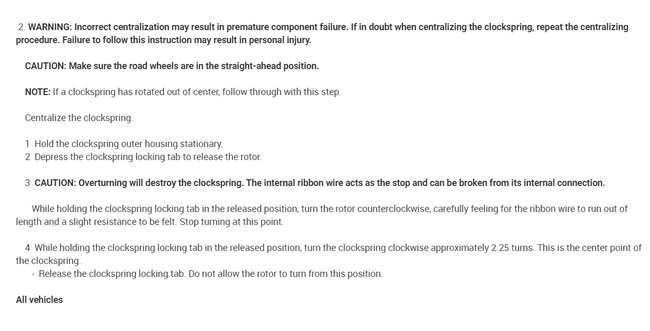

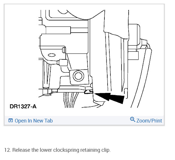

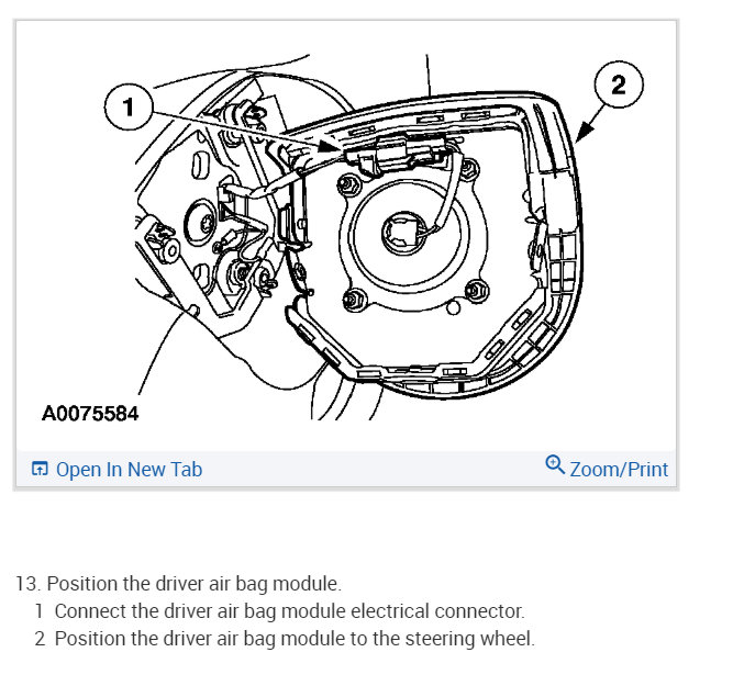

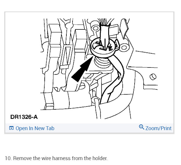

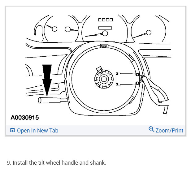

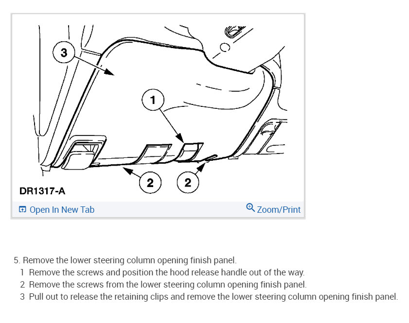

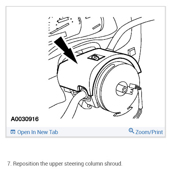

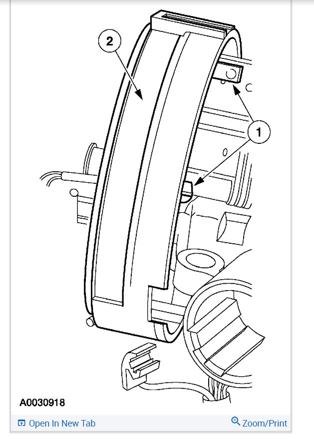

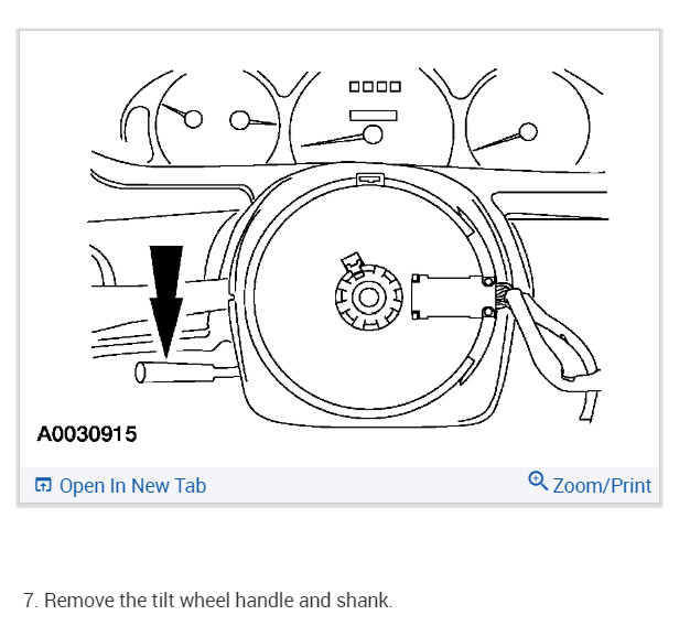

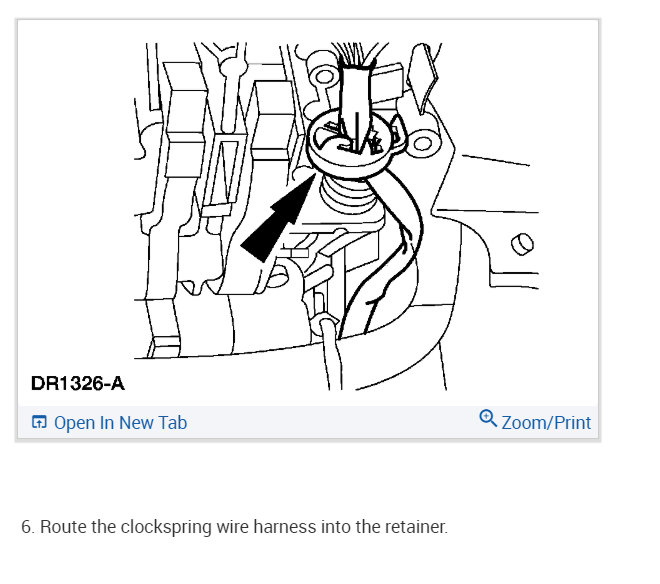

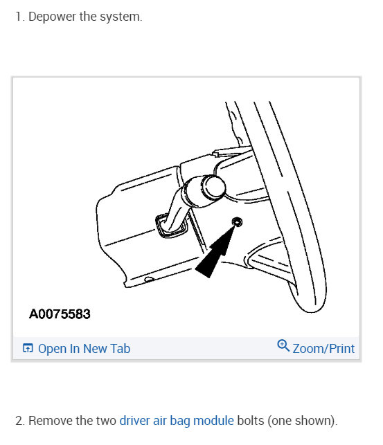

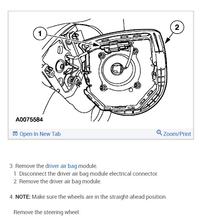

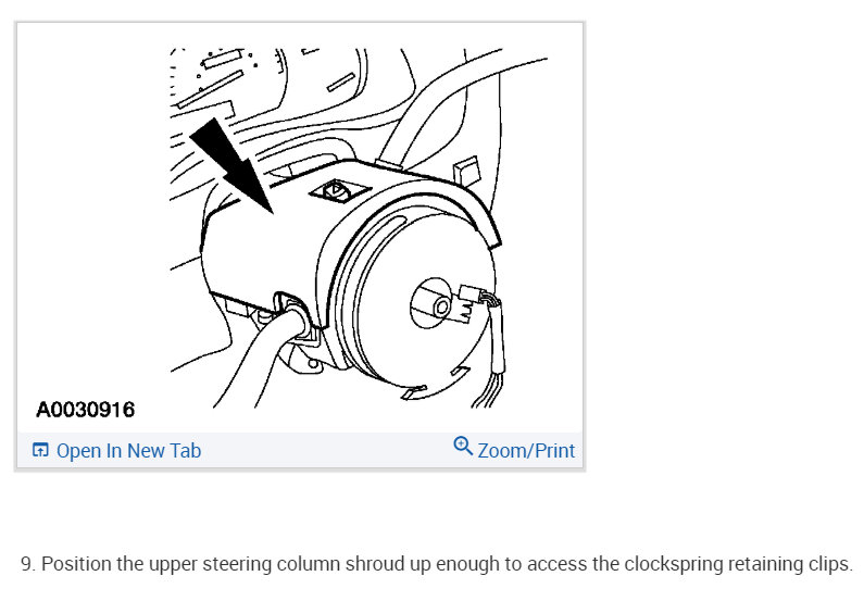

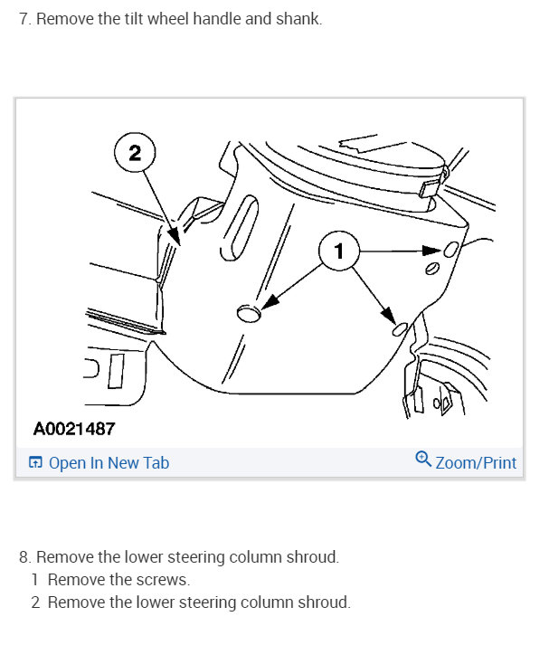

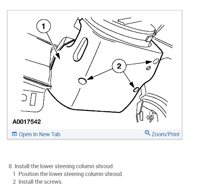

HI there,
9 times out of 10 it will be the clock spring behind the steering wheel here is how you can change it out. To be sure this video will show how to get the codes.
https://youtu.be/gnSGfEqrf_w

most common issue is the clock spring
getting the system check or scanned for codes will pin point the troubled area

CARADIODOC
  • 34,414 POSTS
The computer detected an electrical problem and has disabled the system. The most likely cause is a broken clock spring under the steering wheel. If I'm right and it continues to break, eventually the horn and cruise control will stop working.
