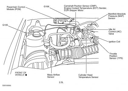

I tested the vacuum and it was running about a steady 20, acceleration normal, which is good. As far as the mass air flow sensor. I am not sure which one it is. My chevy does not have one. It is not listed on the emissions label or in the manual. I may have to get a book unless you can describe its location. It is a 4 cylinder, fuel injected.

DAVE H
  • 13,384 POSTS
Mass Airflow Sensor (2.3L).......Right side of engine compartment, within air cleaner assembly. See Fig. 2 .
Mass Airflow Sensor (3.0L).......Right side of engine compartment, within air cleaner assembly. SeeFig. 3 .
Mass Airflow Sensor (4.0L)........Right side of engine compartment, within air cleaner assembly. SeeFig. 4
https://www.2carpros.com/forum/automotive_pictures/266999_maf_1.jpg
