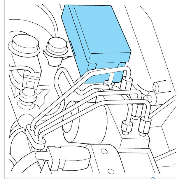

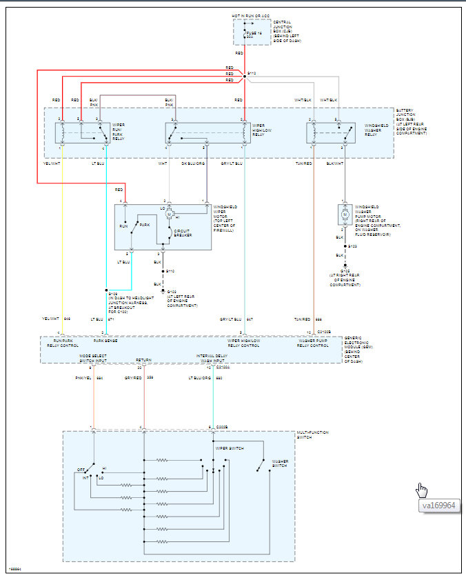

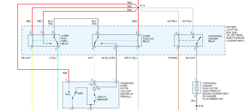

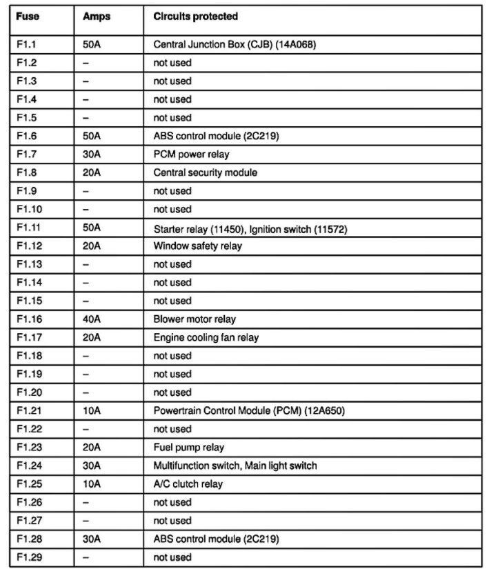

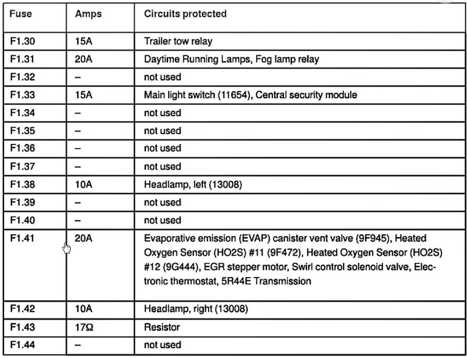

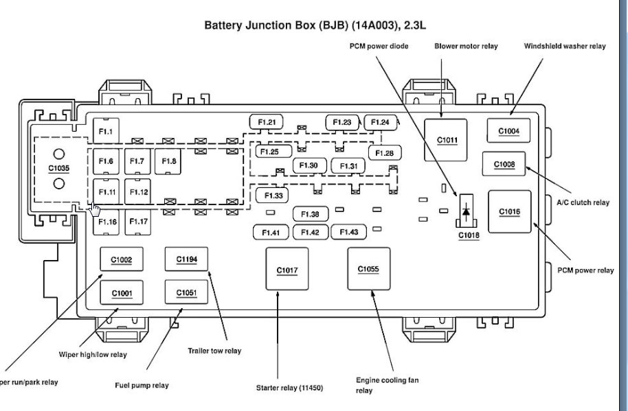

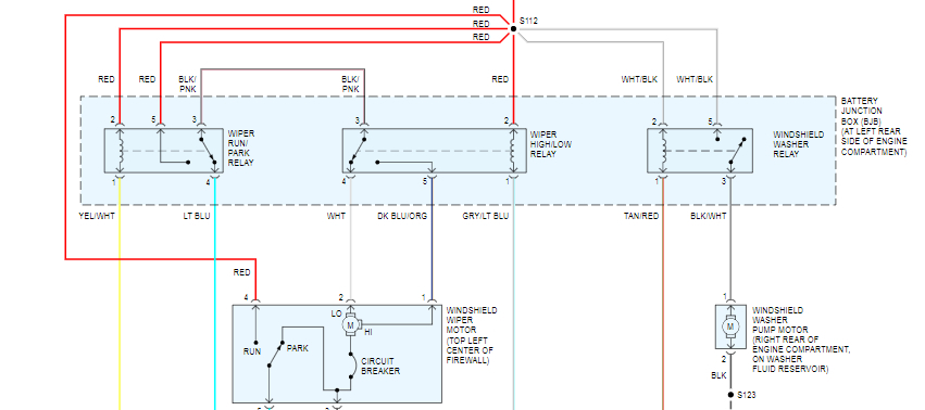

Where is the wiper relay for the wiper motor, in the power distribution center. How can I test it?
Tuesday, March 9th, 2010 AT 6:54 PM
MECHANIC
18,907 POSTS
I am attaching a guide here that will help with testing this relay.
Also, below you will find the detail about where it is and the wiring diagram that will help with this.
Let us know if you have questions. Thanks
