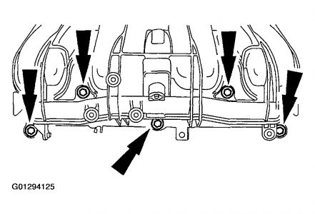

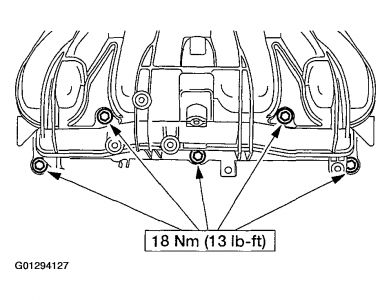

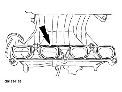

we have all the bolts out the intake manifold, except we can locate the bolts next to the cab. where are the rear bolts to finish removal. the intake is lose, there is at least one bolt left some where and we can not find it.
