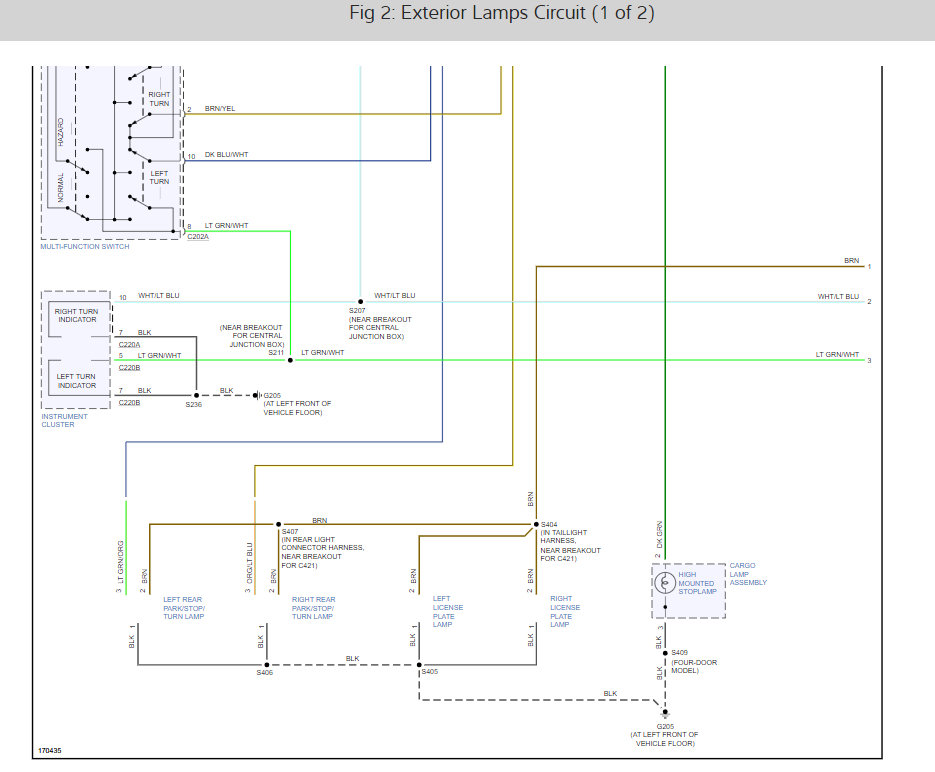

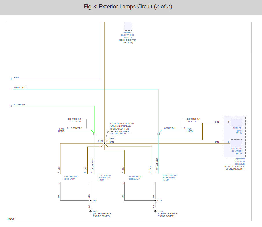

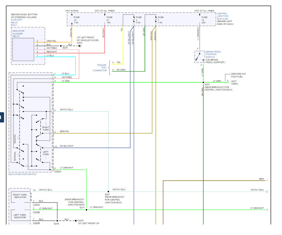

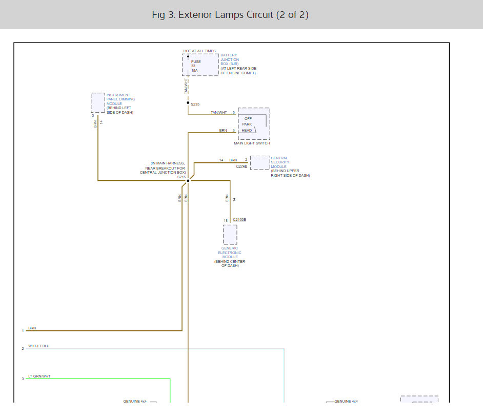

Do you have headlights if so the headlight switch is defective-it has an open in park position. No headlights check fuse no.33 15amp at battery junction box at left rear side of engine compartment. Here are the running light wiring diagrams so you can see how the system works and a guide. to help you check the connections.
Check out the diagrams (Below). Please run this test and get back to us.

yes i have headlights, high beam and low beam, just no tail lights,

What about brake lights? If so you have an open wire between the switch and lights.
