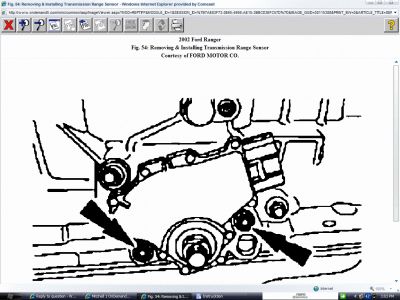

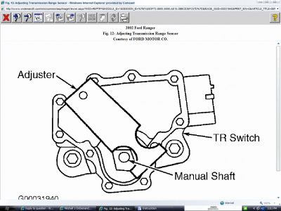

where is the transmission range sensor located and how many prongs does the connector have for it? do you have a diagram of where it is located?

Are you getting a code for it? Or can't start the truck? To install one of these you need an alignment tool....it's located where your shift lever is...
https://images.2carpros.com/forum/automotive_pictures/62217_Trans_Range_Sens2_1.jpg
https://images.2carpros.com/forum/automotive_pictures/62217_Trans_Range_Sens1_1.jpg

yes we are getting a code for malfunction or out of position. Probable causes: Defective sensor or open or short circuited condition. Is there a way for me to adjust it or do I need to take it to a garage?
