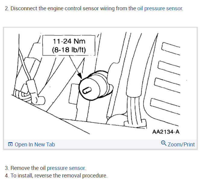

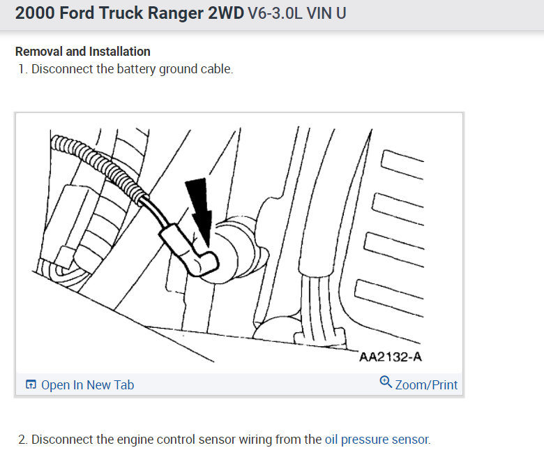

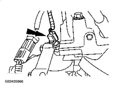

trying to find the oil pressure sensor on the engine?
Apr 5, 2009 at 6:35 AM
DAVE H
  • 13,384 POSTS

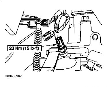

Oil Pressure Switch (2.3L)On left rear of cylinder head. Oil Pressure Switch (3.0L)On right rear of engine. Oil Pressure Switch (4.0L)On lower left front of engine. OIL PRESSURE SWITCH Removal & Installation Disconnect the battery ground cable.Disconnect the engine control sensor wiring from the oil pressure sensor. Fig. 150: Disconnecting Oil Pressure Sensor Courtesy of FORD MOTOR CO.
https://images.2carpros.com/forum/automotive_pictures/266999_oil_1.jpg
Remove the oil pressure sensor. Fig. 151: Removing Oil Pressure Sensor Courtesy of FORD MOTOR CO.
https://images.2carpros.com/forum/automotive_pictures/266999_oil2_1.jpg
To install, reverse the removal procedure.

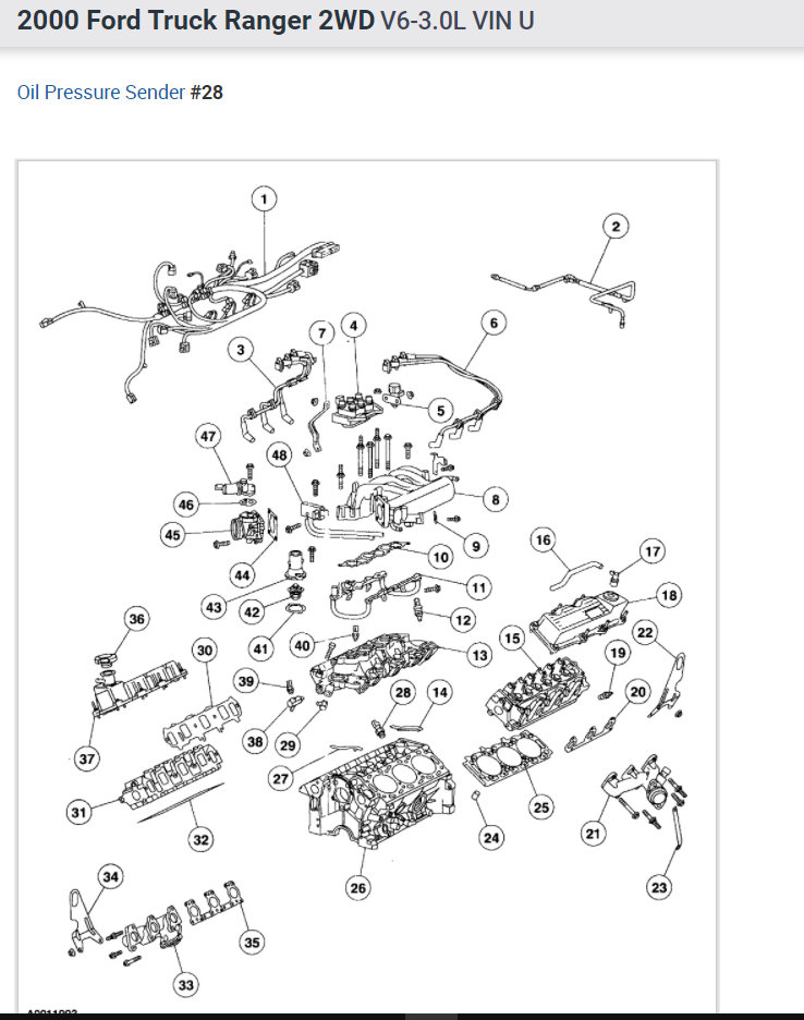

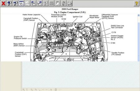

where is the oil sending unit located on a 2002 ranger 3.0
Dec 7, 2020 at 8:28 AM (Merged)
BLUELIGHTNIN6
  • 16,542 POSTS
oil pressure switch is on right rear of engine

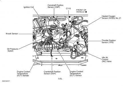

where is the location of the oil pressure sensor?
FAIRRACING31
  • 150 POSTS
Passenger side behind cylinder head in the back of the engine block.
https://images.2carpros.com/forum/automotive_pictures/103836_oil_pressure_switch_3_0_2.jpg

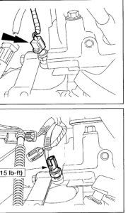

EAGLESCT06
I was just told by the Ford dealer that my oil pressure sending unit was bad and that they wanted $100 to repair it so I decided to do it myself. I purchased the part but I cannot find the sending unit anywhere that I have looked on the engine. Can you please explain to me where it is or better yet show me a picture.
  • 75,992 POSTS
3.0L On right rear of engine-see below
https://images.2carpros.com/forum/automotive_pictures/12900_opsu_9.jpg

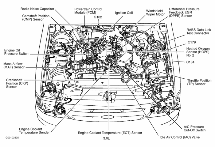

JOHNWAYNE
Where is the oil pressure sending unit on a 2000 Ford Ranger 3.0. It is not where people said it would be
Dec 7, 2020 at 8:29 AM (Merged)
DOCFIXIT
  • 18,828 POSTS
The oil sending unit is located at the right rear of the engine. Check out the diagrams (Below). It is labeled "Oil Pressure Switch"

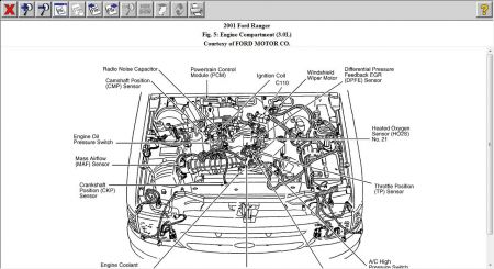

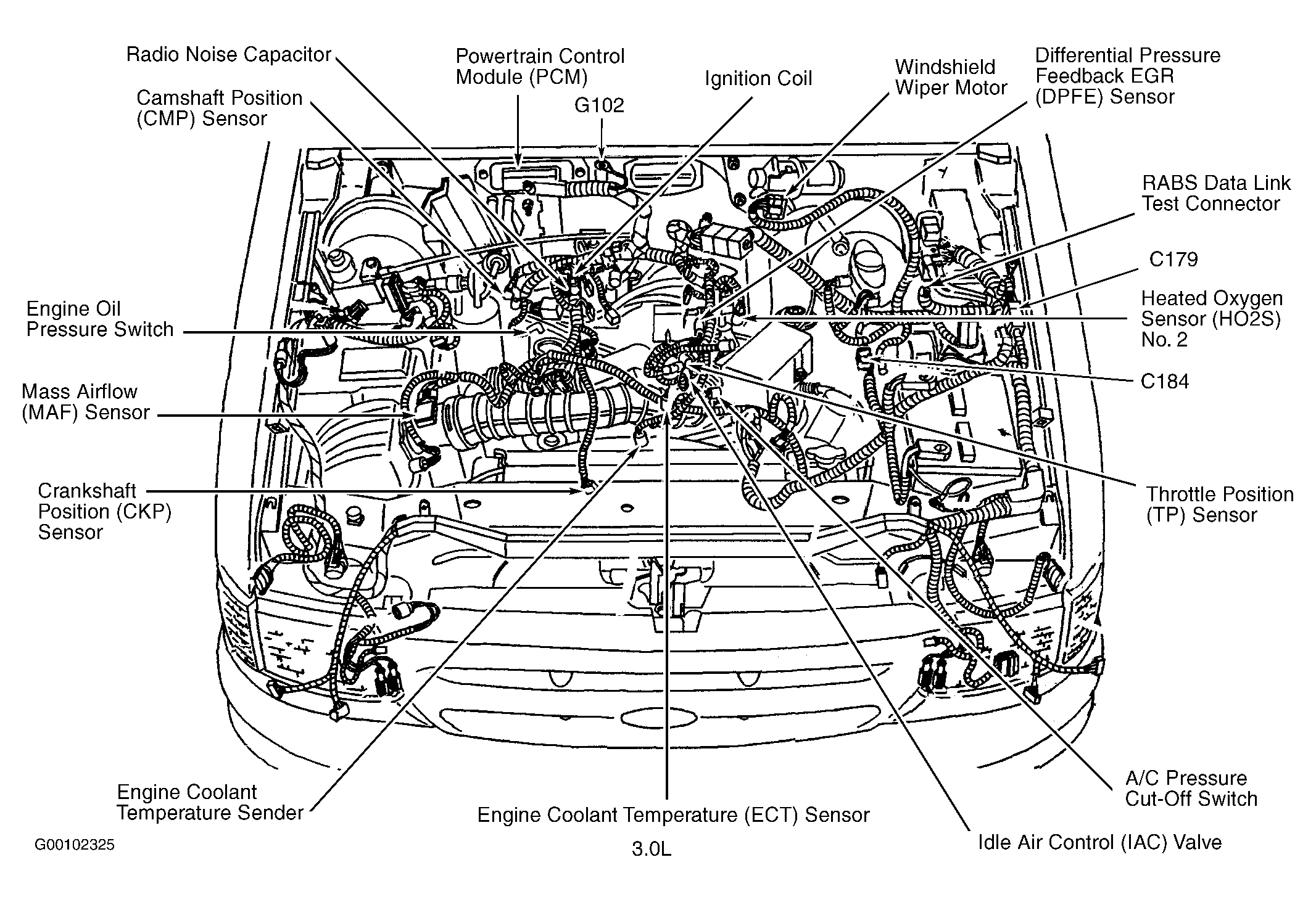

DWAYNE750
where is the oil sending unit on 2000 ford ranger xlt
  • 75,992 POSTS
3.0L on right rear of engine
https://images.2carpros.com/forum/automotive_pictures/12900_oil1_1.jpg
4.0L at lower left front of engine
