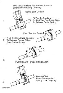

how do i take off a gas line coming from the fuel filter to the motor on a 2002 ford ranger. the lines are leaking and i need to replace the line how do i take it off

https://images.2carpros.com/forum/automotive_pictures/99387_Graphic1_585.jpg
