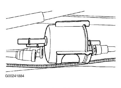

The fuel filter should be located on the drivers side on the frame back towards the gas tank.
Slide under the truck in front of the back tire and look on the inside of the frame you will see it.

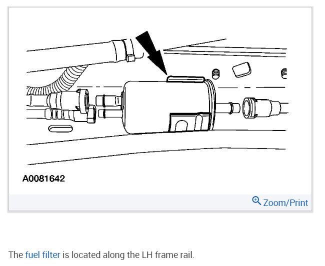

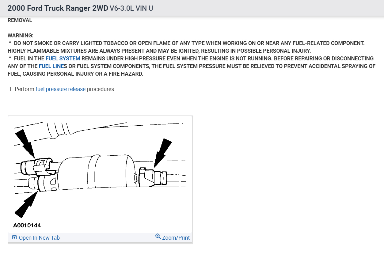

Left frame rail just below drivers door.
Saturday, August 25th, 2018 AT 3:24 PM (Merged)
  • 110,029 POSTS
Driver's side mounted on the frame rail.

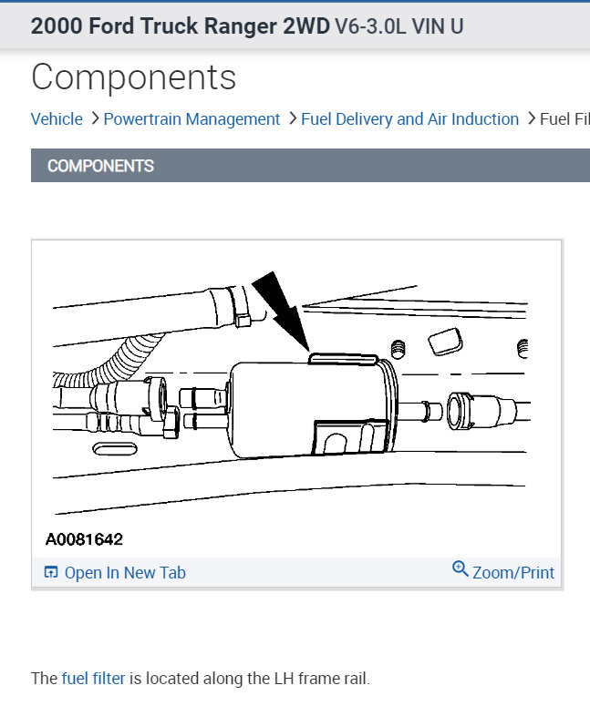

Where do I find the fuel filter on my 2000 Ranger? Is it on the bottom of the engine, or somewhere else? Thanking you in advance.
MERLIN2021
  • 17,250 POSTS
Most Fords it is on the frame rail
ROB2008
  • 258 POSTS
Under vehicle, driver side, below seating area, front of fuel tank, mounted on frame rail in fuel line. Check out the images (Below). Please let us know if you need anything else to get the problem fixed.

Under vehicle located underneath the drivers door. You can do it yourself but you need a special tool that ford makes, as for the check engine light if you have an AutoZone in Hawaii get the codes and post them here.

It is located under the seating area bolted to frame inline and yes you need special tools.

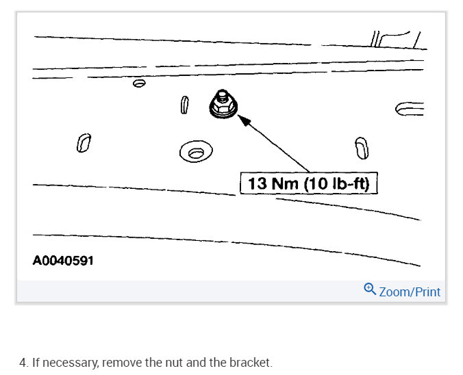

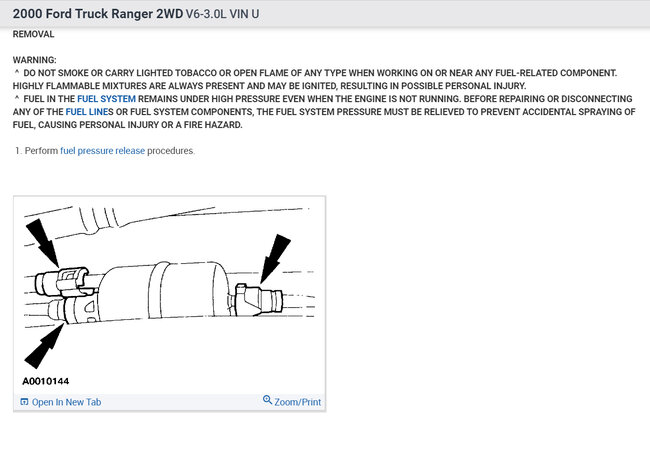

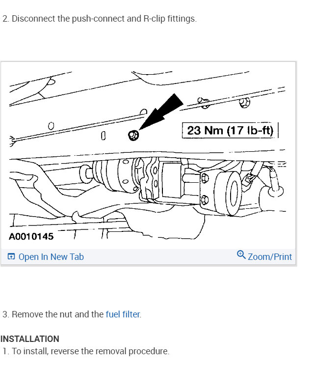

DAVE H
  • 13,384 POSTS

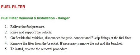

Removal and Installation:
Note:There is an early and late build version fuel filter. The procedure is similar for both.
Disconnect negative battery cable. Release fuel pressure. See FUEL SYSTEM PRESSURE RELEASE . Remove fuel filter fittings. See FUEL LINE CONNECTORS . Remove fuel filter from bracket. See Fig. 88 . If necessary, remove the nut and the bracket. To install, reverse removal procedure.
Fig. 88: Removing & Installing Fuel Filter (Late Build Shown; Early Build Is Similar)

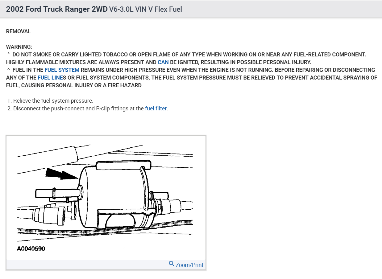

I need to replace the fuel filter on my 2002 Ford Ranger. Could you please provide the steps?

BLUELIGHTNIN6
  • 16,542 POSTS
https://www.2carpros.com/forum/automotive_pictures/261618_Noname_2003.jpg
