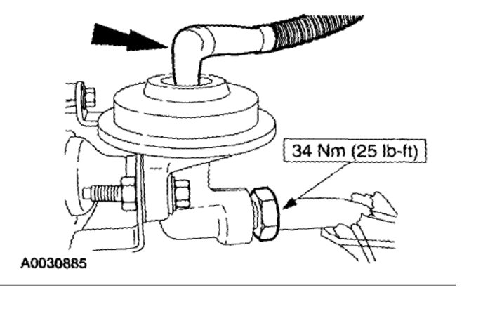

I have a engine shimmy/bump/shake at idle. I got a number 5 misfire and replaced the plugs, wires and ignition coil but the still have the problem. I've looked to replace to EGR valve but cannot find it. Checked other forums and some have said there isn't one and some said there is. While others said to replace the DFPE. Need some guidance on this.
Nov 5, 2010 at 5:48 PM
  • 55,649 POSTS
Hey RBOLISH,
The EGR valve is located bolted to the intake manifold with a vacuum line going to it. Here is what it looks like, Please let me know if you need anything else to get the problem fixed. There are two styles. (Below). Please let us know what happens.
Dec 16, 2016 at 7:13 AM

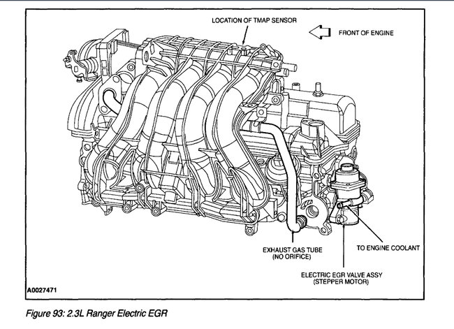

Where is the EGR valve located on a 2001 Ford Ranger 2.3L ?

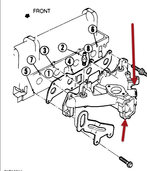

we don't have a good picture of that at all only the valves there are a few different types.with something that old you'll have ot find another vehicle with same engine unless I can find something on the ford site. see pic and it gives a few ideas where it may be located. or at base of carb which if it were there would have aplate to it.

The EGR valve is on the drivers side of the engine, with the tube going into the intake manifold.
