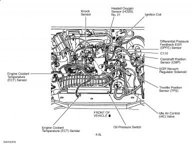

Where is the DPFE sensor located and what is the code for the check engine light after the sensor is replaced to turn the checkengine light off? Also where do you enter the code?

left side of engine, pictured below..
https://images.2carpros.com/forum/automotive_pictures/261618_Graphic_80.jpg
you need a diagnostic scan tool to delete the stored trouble codes, or just disconnect negative battery cable for 10 minutes then reconnect..
