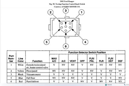

When I turn on my ac the air comes the heater vents instead of the vents on the dash. Could there be a hose not connected?

Could be the vacuum servo or control head leaking vacuum, or like you asked a disconnected vacuum hose
