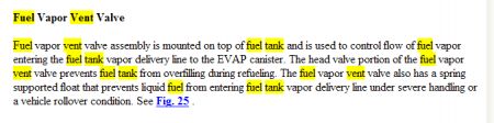

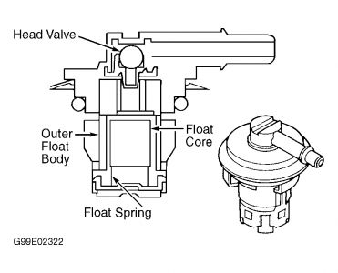

win i put gas in the gas tank it will push it back out. the in take line were i put it in is clear
and the over flow line is clear.

Hello It is possible that your vent valve is not working properly. Also, check the lines going in and coming out of the tank for kinks and damage of any kind.
