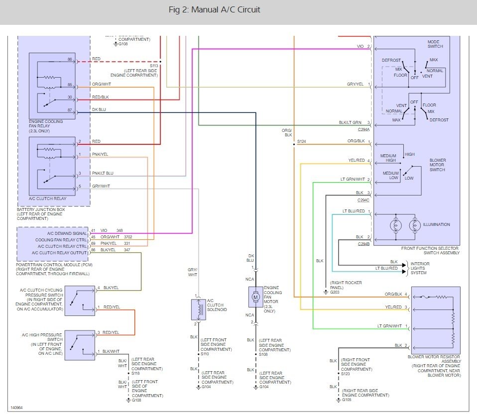

The AC on my Ranger will not cool. This started last fall as an occasional problem. At first it seemed that it just took an extraordinarily long time for the AC to start cooling. I found that repeatedly switching the AC on and off would cause it the compressor to start (I can tell when it kicks in because of the slight drop in RPMs) As soon as the compressor starts it cools quickly. This spring it had gotten to the point that it only worked every few weeks. I had a local mechanic look at it, he attempted to "jump" the compressor, checked fuses, etc but nothing would work. A few days later it started working and continued to work for several days. For the last few weeks it will not engage at all. The mechanic told me that it could possibly be the BCM and suggested that we replace it to find out. I'm concerned that this might be a shot in the dark and do not want to pay to replace something that is not the problem.

Hi
No BCM used on Ford a GM feature. With a test light put on A/C compressor turn A/C on off if light glows every time then clutch is worn and gap is too large for magnet to pull in. with A/C on engine runing tap clutch shoe it should engage.

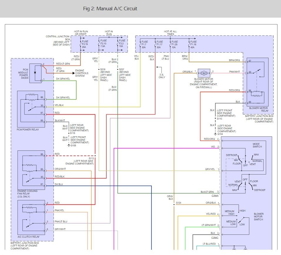

Thanks for replying ... there is no power at the plug to the compressor .... However, if I directly connect the compressor from the battery the clutch engages.
Checked all the fuses and none (that I could locate) are blown.
This obviously indicates that a switch or relay is bad ... any suggestons on where to start?

The compressor will not engage if the system is low. Here is a guide to show you how to check that.
https://www.2carpros.com/articles/air-conditioner-how-to-add-freon
Next there is a compressor relay that may have gone out
Here are some wiring diagrams (BELOW) so you can check the system to see why its not getting power.
You might have a compressor clutch coil that is bad and it needs replacing.
